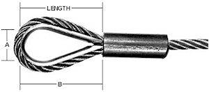

They're braided cable with thimbles:
The length is not adjustable, so I need to finish them with strong line (one zillion pounds breaking force) that can be adjusted to make the safety line taut.

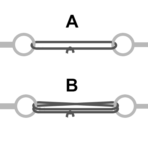

My question is this:
Is a double-loop line (B) functionally stronger than a single loop (A)?
It is elementary that, if the line breaks in either A or B (say, due to rubbing wear), it doesn't matter how many loops I have, it will come apart.
But does the double loop distribute the load, so that it will hold more weight?

The doubled line is, of course, nominally double the strength. But the strength is reduced by the tight radius at the rings, and also by the knot. And of course, if one breaks, you lose everything. Having said that, I think that many loops in the way illustrate is still good practice, and I use it for the shrouds and forestay of my my small boat. Rather than the knot shown, I suggest making several turns then putting half hitches around the bundle in the traditional manner. Actually, for a safety line, I think you can by an adjuster device, which would be safer.
If you double up it's also easier to get tension in the wire because it acts like a block and tackle.
Although it may not apply to the simple examples you presented, don't neglect the friction force in a multiple loop arrangement. It could be beneficial (It may be enough to keep the integrity of the link even if one loop is broken or at least give some reaction time to do something before failure) or it may be detrimental (The friction force may prevent one loop to be fully taut, thus essentially useless).
It all depends on how many loops you have, how you twist them together and what type of rope you are using.

I suppose the simplest solution, given my circusmtances, is to make the two loops independent. Now, if one break, you have a backup.
On the other hand, that arrangement will certainly mean that one will always take more weight than the other, because you can't set them to the exact same tension. That means one of them will always be more likely to fail.

This is only true if you can ensure that both loops will carry relatively equal weight.. If one is looser than the other, it will take all the load, and break just like if it were the only one, and the remaining loop will do the same.
If you can use several loops, and then wrap the bundle several times at each end (Like a hangman's knot), they'd all be load carrying, and even with 1 failing, there's a good chance there's enough friction from the wraps on each end to prevent it from completely unraveling... I'm sure the Ashley book of Knots has specifics on this, but I don't have it handy
Yeah. That's good. I'll do that.

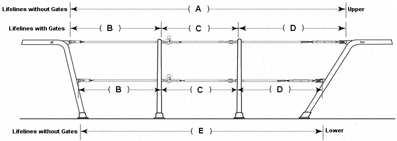

Sorry, you're right. I've been using the wrong term.
Lifelines.
They run between the stanchions.
Hm. That last diagram gives me an idea. I should have used turnbuckles. Too late now. I can't alter the length of the wire cables.
