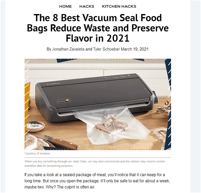

To test audio and various foods to make food last longer. I am looking for an oil-less pump because I am not sure if the oil is safe for the foods.
Do you mean like this?
https://spy.com/articles/hacks/kitchen/best-vacuum-seal-food-bags-256242/
