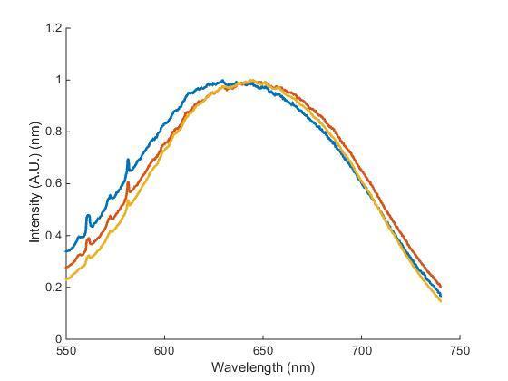

As you said, "since I am measuring a solution containing a mixture of polymer of different lengths, the emission spectrum can vary with excitation wavelength". I have an extending question that can the emission spectrum change from trial to trial under the same excitation wavelength? In fact, I have measured the MPS-PPV in solution under confinement for several times and the results are not exactly the same. I attached the files. Is it normal to have such a variation?
Another question is that most people measure emission spectrum with the molecule of interest in solution (I also did this), can I measure it after the molecule is dried? I have tried it with MPS-PPV, and the spectra are different!

Some of the differences could be due simply to measurement error, but I'm not familiar enough with the spectroscopy of conjugated polymers to say whether the variability you see is normal.
The spectra of fluorescent molecules often depends strongly on their environment (e.g. many fluorophores are pH deptendent, and things like solvent polarity and viscocity can alter their photophysical properties). So, I would absolutely expect the spectra of the dried molecule to differ from the spectra when your polymer is in solution.
