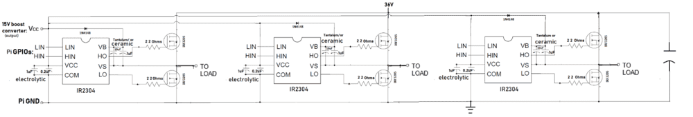

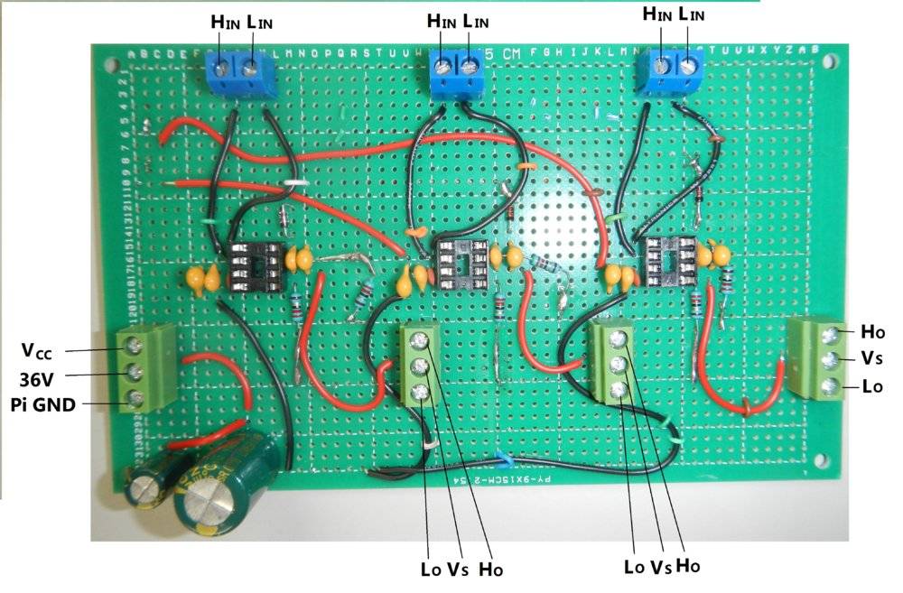

Is anyone familiar with the IR2304 MOSFET driver?
  • Thread starter Thread starter tim9000
    inverter mosfet
The discussion revolves around the IR2304 MOSFET driver IC, specifically its functionality in a three-phase inverter circuit. Participants are exploring issues related to the operation of the driver, including the behavior of various pins, the timing for turning on MOSFETs, and troubleshooting voltage readings.
  • Experimental/applied
  • One participant questions whether the Vs pin goes between VB and COM and seeks clarification on the functionality diagram in the datasheet.
  • Another participant suggests that the low-side MOSFET must be turned on first to charge the capacitor before testing the high-side MOSFET.
  • There is uncertainty about how long the low-side MOSFET needs to be on to charge the Vb capacitor, with estimates ranging from 10 to 100 microseconds.
  • Concerns are raised about whether Vs goes to ground when the high-side output is triggered, with some confusion about the role of Vs as the high-side MOSFET source voltage.
  • Participants express confusion regarding the connections of the LIN and HIN pins, noting labeling issues in the datasheet.
  • One participant reports difficulty in triggering the low-side MOSFET and unexpected voltage readings, suggesting potential damage to the chips or wiring errors.
  • There is a discussion about the necessity of fully controlling the voltages on the Hin and Lin inputs and the implications of not doing so.
  • Participants mention the need to maintain the Vb capacitor charge while the bridge is idle and not driving a load.
  • One participant plans to rebuild the driver and MOSFET setup with new components due to difficulties with surface mount ICs.
Participants express multiple competing views regarding the operation of the IR2304 driver, particularly concerning the timing and control of the MOSFETs. There is no consensus on the exact behavior of the Vs pin or the implications of the voltage readings observed.
Participants note potential limitations in their setups, including the possibility of wiring errors, power supply issues, and the challenges of working with surface mount components. There is also mention of the need for sufficient voltage levels from the GPIO pins of a Raspberry Pi to control the MOSFETs effectively.

Hi Essenmein,
Thanks very much for the reply.
1) I can put a series resistance with the boot strap diode, but why would we want/need to limit the charge current to the caps? Do you mean something like 0.01Ω resistance? for example
2) what size ceramic boot cap do you think I should use across VB and VS?
3) Okay, if you think I should leave the 1MΩ resistors in there, I'll do so.
4) I'll keep the loop inductances in mind, if I get any issues, I will put some 16V zeners into protect the gates. In future designs I will do it anyway.
5) Alright, I will remove the capacitance and inductors from the BLDC inverter and implement this in future non-BLDC inverter designs, when I hopefully have a more clear idea about how the inverter is operating.
6) So you're saying that with FET (i.e. MOSFET) the internal body diode should already be able to handle the current?
7) Okay, refer to my point #5.
8) I'm not sure what you are saying here. I have tested the output of my hall sensors and it triggers my code to output the three phase sequence as per a binary table I got online. So I am hopeful about the control code for the BLDC.
Thanks!
  • #59
essenmein said:
1) Put a small series resistor with the boot strap diode, makes life bit easier for it since limits the charge current to the caps.
Initial current is limited sufficiently by the circuit inductance, foil and diode resistance, and supply rise-time.
essenmein said:
2) You should not need such large boot caps, it only needs to provide hold up for one cycle and your gate charge is not that much, then you need to have a boot charge initial pulse (ie turn all low sides on before starting drive).
The proposed mosfets have huge gate capacitance, so will require significant drive charge through the 60mA driver. For the very low PWM rate expected from such weak drivers with such high cap loads, I would increase the capacitance to maintain sufficient gate drive.
essenmein said:
3) I'd leave the 1M ohm in there, its standard practice for us to have several 100kOhm in there to keep gates from building charge in case of a disconnect or failure (there is usually a lot of energy on the DC bus that an erroneous turn on would cause some erm "problems").
Those idiot resistors are always across the bridge drivers and bootstrap caps. Those structures should maintain gate off conditions during power up and down. If there is no gate control because the circuit is broken the fuse will blow.
essenmein said:
4) Its not a bad idea to put a 16V zener gate to source to protect the gate from transients (depending on how you are building this when you start to switch currents they will become a problem if your loop inductances are too high).
The mosfet gates are sufficiently protected by internal zener diodes and by external gate stopper resistors.
essenmein said:
5) A motor designed for inverter/PWM use should NOT have any capacitance added between windings. Cut them out if you can.
Those capacitors are not for the motor, they are part of the inverter output low-pass filter. This inverter is not designed to be an efficient motor controller.
essenmein said:
6) Do NOT use external freewheeling diodes unless you are using IGBT, FETs have them for free, and they are typically rated with the same current as the FET. Plus that diode should only be conducting during the dead time if you are being good and switching both HS and LS actively.
This inverter is designed to have both Hi and Lo sides in continuous PWM. The flyback diode is not being used for soft commutation as would be done in an energy efficient motor controller.
essenmein said:
7) Do not bother with filtering on the output of the inverter, motors have large inductances (that is after you get rid of the caps).
8) Distinct lack of motor phase current sense, which is needed to do any meaningful motor control.
But tim9000 is generating a variable frequency three phase voltage output, then running the motor as a synchronous motor. That is why low-pass output inductors and capacitors are needed for this 3PH inverter voltage source. Vector current control is NOT being used for torque management as it would be in a motor controller.
  • #60
I was actually thinking about putting something like 0.1uF, 1uF, and 10uF ceramic caps in parallel so it would charge up fast and hold significant charge. Just a thought. What do people think?
As I just said (post #58), I'll remove the capacitors & inductors for the BLDC specific application, since LC filtering isn't necessary.
?? So the 1MOhm resistors aren't just unnecessary, but they are a BAD idea?

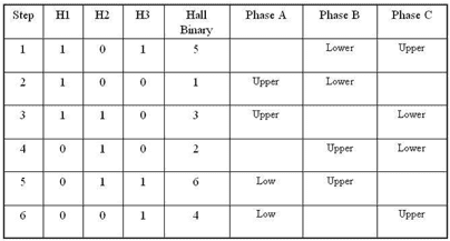

The motor is trapazoidally wound, not sinusoidally distributed windings. This is not a sine wave output inverter. As I said previously, I am using a standard step binary table controlled by the position of the hall sensors, e.g.:
And another opposite table output for reverse rotation direction.
Okay, I won't bother with the 16V zeners here or in future projects then.
Thanks!
