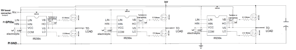

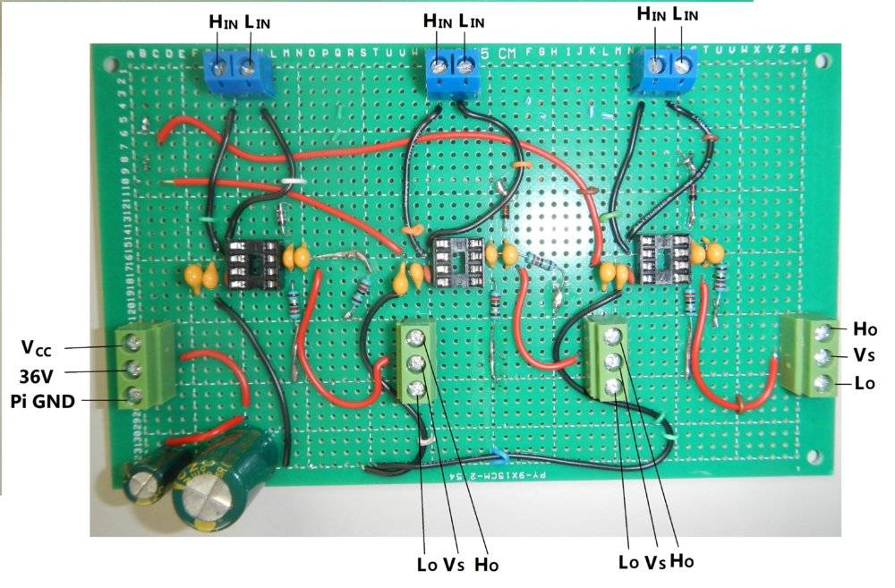

Update, I have finished soldiering the MOSFET driver. Can people please have a look at the attached pictures and offer thoughts. The circuit shown is the part of the circuit which interfaces between the micro-controller and the MOSFETS. So basically it houses the ICs and the digital outputs from the raspberry PI are wired into HIN and LIN. (There is a separate module for the Hall sensors to interface with the PI).
HO, VS and LO are connected to the mosfets as per the attached circuit diagram.
Much appreciated and sorry for the long delay.
P.S. in case you can't make the diode out in the circuit diagram, they are 1N4148 small signal diodes which have a forward conduction in the nano-second range from memory. I think they were rated for about 500mA or something.
The MOSFETS are NMOS IRF3205. I am willing to change these components if necessary, same goes for the IR2304. Happy to go with IR2301 if necessary, but will need to implement some anti-shoot through in the code to accommodate that IC. (Also would consider IR2104 if anyone thought it was preferable).

Be aware that the left two IC sockets are oriented wrong. The orientation notch is pointing downward in the photo putting pin one at the lower-right, but they are wired as if pin one is at the top-left.
The 0.2uF capacitors on pins 3&4 of the ICs are labeled as electrolytic, and their shiny body indicates they may be. I would expect them to be disc ceramic. Please verify they are correct per the original design, datasheet, or application note.
Of course we can't see the polarity markings on the caps, so double-check them before applying power. (they really stink with the wrong polarity, and sometimes emit sharpnel shrapnel)
Cheers,
Tom
p.s. the Fairchild 1N4148 is rated 200mA average current, probably fine.

Woops, I didn't even notice the IC sockets had a notch! Thanks for pointing this out.
Also, apologies about the circuit diagram, it is out of date, are pins 3&4 Vcc and COM? (I don't have the datasheet on me at the moment). If so, this is a symptom of me needing to update the diagram, they are actually 1uF & 0.1uF tantalum and a smaller size ceramic capacitor. I can't remember if this was a specific requirement of capacitance across Vcc and COM, I assume it's enough.
I remember that some weeks ago I did a rough calculation (using the App note) for the capacitance across Vs and Vb and I concluded that 1uF & 0.1uF was enough, these are tantalum incidentally. I DIDN'T REALISE THESE WERE POLARISED, so they might be the wrong polarity. How can I tell? There are no markings and both the legs were equal in length.
P.S. Another thing I didn't realize until now is that tantalum caps were electrolytic, SO I HOPE THESE DON'T HAVE TOO MUCH LEAKAGE CURRENT...??

Tantalum caps are polarised, with a solid tantalum oxide dielectric, so they do not have electrolyte and do not dry out. Cheap tants can have high leakage but reliably branded ones usually have low leakage.

Hi All,
I'm trying to get back on this horse, this thread hopefully isn't dead yet. To refresh you're memory this was a brushless DC motor to be run from 36V lithium batteries. The controller between the bldc hall sensors and MOSFET drivers was a raspberry pi.
(So I've been getting smashed at my new job, 11 & 1/2 hour days during the week and working on the house on weekends. I've been having to do not just design engineering at work but also because it's a new-ish company also the QAQC, [most of the] draughting developing all the system processes like testing, manufacturing ITPs, drawing conventions/register etc. etc. ...Also, we have our 3rd child on the way!)
I've been trying to find all my project notes since moving house and I think I've more or less found everything to resume the project.
To re-cap where I'm at, from memory from six months ago (hazy):
-Despite being an inductive load (bldc motor) I was going to forego the schottkey diodes in parallel with the mosfets and see if the internal body diodes can handle the flyback current. (Otherwise I'll use 1N4148 diodes. These apparently have a reverse recovery time of 8 ns and a 100V breakdown voltage.)
-There was previously an issue of me possibly not firing the Lo for the Vb capacitor to charge up.
-I was using the of the IR2304 gate driver and I'd already made my circuit board to house them. So due to time constraints I would still like to use this driver, sacrificing fast switching time for something that still 'just does the job'.
-The input capacitance of the previous MOSFETs was 3247 pF which we concluded would not be suitable for the IR2304 to be able to drive. I now want to use an NMOS with an input capacitance of 920pF (the F40NF06). I am hoping that this will make up for the low pulse current (60mA) of the IR2304).
Can someone please advise if these conditions are going to be an obvious non-starter. Failing this I will have to use the IR2301 (120mA) gate driver and make a new circuit board and re-code so it creates and artificial anti shoot-through on switching.
Thank you
  • #81
But they are signal diodes, not power diodes. The peak MOSFET current will flow through the 1N4148 momentarily. You need to use the integrated body diode, or an external fast recovery diode rated for repeated pulses of Imax.
