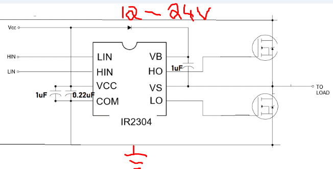

Hi All,
I'm not sure if this is the correct foray to discuss my questions about the specific IR2304 IC chip.
However, I've run into some difficulties making my first inverter and I've asked a range of questions on another website:
https://forum.allaboutcircuits.com/threads/using-the-ir2304-s-for-the-first-time-to-make-a-three-phase-inverter.155886/#post-1345395
(datasheet and circuit sketch attached to the linked thread)
but I've not had a reply.
I'm wondering if anyone knows from experience if the Vs pin goes between VB and COM? And if someone can elaborate on what the functionality diagram in the datasheet is with reference to?
I believe not what Hin must be pulsed to 'bootstrap' the capacitor, so I don't think I can really test the driver's circuit operation just using a DC source and voltmeter.
Thanks
You must turn on the low-side mosfet first, so as to charge the capacitor, only then can you turn on and test the high-side mosfet.
Maybe you could drag and drop your circuit for one phase onto your next post.
Thanks Baluncore,
That is really strange, how long does the low-side mosfet have to be ON for before I can trigger the high-side?
The circuit is approximately this:
With Vcc being 15V, and the COM being connected to the GND of a raspberry pi, similar for Hin and Lin to the GPIOs.
So do you know if Vs goes to GND when the HO is triggered? or is Vs always Vcc?
Thanks again!P.S.
I just tried triggering the lower mosfet first, however, I COULDN'T GET IT TO TRIGGER AT ALL!
I was expecting LO to be equal to Vcc, however, it was closer to 0V.
Also I noticed that Hin and Lin went between a couple volts and zero, I was expecting they would just be zero. Perhaps I damaged the chips?
P.P.S. it really bugs me that the output to the load was Vcc, as I would like the mosfet controller to be separate, as I expected it should be.
Just long enough to charge the Vb capacitor. Initially, maybe 10 to 100 microseconds.
When LO goes high, the low-side mosfet is turned on. That pulls Vs to ground and charges the Vb capacitor through the diode from Vcc. That then supplies the capacitor voltage needed later to switch the high-side mosfet gate between off and on.
You are confused. I wonder what exactly you mean by triggered. Vs goes low when LO is high. Vs is the high-side mosfet source voltage which is the half bridge power output, not a supply.
Hin and Lin control voltage thresholds are below 0.8 for low and above 2.3V for high. Your Rpi must supply that voltage.
Vcc is selected to be sufficient to fully turn on the mosfet gates.
You must fully control the voltage on the Hin and Lin inputs. If input voltages do not change it is probably because you are not fully controlling them. The internal interlock between the Lin and Hin require those inputs be fully controlled at all times.
It is possible that your power supplies are not functioning as you expect, or that you have a wiring error in your prototype.
While the bridge is idle and not driving the load, you should turn low-side mosfets on, so as to maintain Vb capacitor charge in preparation for the high-side mosfet to be turned on.

Take a look at pin 1, labeled LIN. It is connected to HIN.
Pin 2 has the same labeling problem.
Confusion anyone?
Confusion anyone?
Ha! You're right! I didn't notice that. This bloody datasheet is a real turkey.
When LO goes high, the low-side mosfet is turned on. That pulls Vs to ground and charges the Vb capacitor through the diode from Vcc. That then supplies the capacitor voltage needed later to switch the high-side mosfet gate between off and on.You are confused. I wonder what exactly you mean by triggered. Vs goes low when LO is high. Vs is the high-side mosfet source voltage which is the half bridge power output, not a supply.Hin and Lin control voltage thresholds are below 0.8 for low and above 2.3V for high. Your Rpi must supply that voltage.
Vcc is selected to be sufficient to fully turn on the mosfet gates.You must fully control the voltage on the Hin and Lin inputs. If input voltages do not change it is probably because you are not fully controlling them. The internal interlock between the Lin and Hin require those inputs be fully controlled at all times.
While the bridge is idle and not driving the load, you should turn low-side mosfets on, so as to maintain Vb capacitor charge in preparation for the high-side mosfet to be turned on.The high voltage supply will usually be significantly greater than Vcc, and often greater than the Vgs breakdown voltage of the mosfet. For higher voltages the supplies must be separate, and the Vb voltage must stay close to, and above Vs by Vcc.
Thanks for some more insight into the operation and clarification about Vs.
So the Vb cap won't charge unless the LO mosfet has pulled Vs to ground, I didn't realize that, because I always measured Vs as being Vcc, and I was expecting it to be 0V (floating disconnected internally). I.e. there is Vcc volts coming out of the Vs pin on the chip.
Oh God, I'm so confused now.
Only the external labels were swapped on the diagram. It makes no difference to the product or terminal identification. The terms are correct throughout the rest of the data sheet.
If you are still confused about the application of the IR2304 or IRS2304 half-bridge drivers you should ask a specific question.
Now you need to test the circuit by controlling the Lin and Hin signals.
Check that you have tied the drain of the low-side mosfet to Vs, the source of the high-side mosfet as shown in the diagram. If you do not do that you will be unable to charge the Vb-Vs capacitor.
When pin Lin is low, Lo will be at Gnd which will turn off the low-side mosfet.
When pin Hin is low, Ho will be at Vs which will turn off the high-side mosfet.
Do not take pins Lin and Hin high at the same time.
When pin Lin is high, Lo will be at Vcc which will turn on the low-side mosfet which will charge the Vb-Vs capacitor.
When pin Hin is high, Ho will be at Vb which will turn of the high-side mosfet.

1. You do not have to insert the picture into the post, you can simply attach it.
2. The IR2304 is a low current gate driver so you should select a mosfet with a low gate capacitance. That mosfet will need a fast parallel flyback diode as it is driving an inductive load.
3. The resistor between the driver and the mosfet gate can be 22 ohm. It is there primarily to prevent a parasitic ultrasonic oscillation between the driver and the mosfet gate which might damage the gate and cause electrical noise. If the resistor value is too high it may limit the driver current to the gate during transition.
4. I would not bother with the 1 MEG resistor as the driver will clamp the gate voltage.

I am currently using IRF3205 NMOSFETs, what am I looking for on the datasheet to this end? And what range should I be hoping for?
The datasheet for the 3205 says:
total gate charge: 146 nC, gate to source charge 35 nC, gate to drain charge 54 nC
input capacitance 3247 pF
output capacitance 781 pF
reverse transfer capacitance 211 pF
reverse recovery charge 143-215 nC
I was using some 1N5817 1A Shottkey diodes. Could you please suggest some? (Googling suggests: 1N4001?) Does the flyback diode need to be directly on-top of the MOSFET pins, or could it be on the circuit board of the chip?
All mosfets have an intrinsic body diode, some have a fast Schottky diode included in the package. If they do not include the diode you will have to place one as close to the mosfet as possible. The common 1N4001 will NOT survive the inductive application. What inductor current do you expect?
You will need to browse the selection tables provided by mosfet manufacturers. Mosfets for motor drive applications will include a fast recovery schottky diode matched to the mosfet current and speed.
The flyback diode should be schottky so it will conduct before the body diode. It must be fast so there is minimum transition overshoot, which also explains why it must be close to the mosfet. The body diode in the IRF3205 may be sufficient, but I would expect to find a better mosfet in the selection tables.
The IRF3205 has a high capacitance because it's high current requires a large area die. Select a lower current device and you will find it will switch faster. Also, consider later generation mosfets. Alternatively, select a higher current half bridge driver.
Again, browse the selection tables provided by the mosfet manufacturers. Learn to read the data sheets.
Also, see the selection filters available on suppliers websites such as digikey, mouser, element14, RS etc.
1) The IRF3205 data sheet shows Trr (reverse recovery time) as 104ηS. That would seem adequate for the motor since the schematic shows capacitors across the motor windings. Depending on the motor load current, the series inductors could cause trouble if they are less than about 6μH. That would put the peak of the first ringing pulse at less than the switching time of the body diode. I don't have a 'good' guess for the inductors, but it sure feels like the inductance of 80 turns on a toroid would be substantially higher, in the range of milliHenries.
2) Do not use electrolytic capacitors for the Boost cap, their high leakage current will limit the maximum pulse width.
2a) As @Baluncore said, drop the 1M resistors in the gate circuit; they are effectively the same as leakage current. (just don't turn on the 36V power without the driver chips being functional)
If you wish to calculate the needed value of the Boost caps, there is an explanation and formula on pg.6 of:
https://www.infineon.com/dgdl/Infin...N.pdf?fileId=5546d462533600a40153559f7cf21200
They talk about a slightly different chip but the basics are the same.

Ah, so I can use electrolytic between Vcc and COM, but use a ceramic between Vs and VB?
Yes, that is my gut feeling on the inductors too, I'm just hoping they don't saturate.
What are you envisioning to occur will happen with the 36V if one of the chips breaks? What will happen mid operation if one goes faulty? Is there a way of detecting and protecting for this scenario?
I'm looking at your infineon .pdf now, cheers.
As always, thanks!
P.S. I can also see there is the 1N5817, 1N5818, 1N5819 range. But I'm not sure if dV/μs is related to trr, other than that, I can't see the reverse recovery time explicitly stated...Also, what reverse voltage does the flyback diode need to be rated for, 36V?

Considering how cheap the MOSFETs are, I'm inclined to ignore adding a Schottky diode until it is proven they are needed.

Do you have a make & model of one you have in mind... and/or perhaps you can tell us what it will be driving at what speed.
That would leave the MOSFET gates floating which means they may partially turn on. If both the upper and lower ones turn on you have a short circuit across the 36V supply. A fuse would likely avoid a spectacular failure but not necessarily save any MOSFETs or the power supply.

It would be helpful if you specified the maximum output current that will flow in the mosfets.
You should also specify the switching frequency.
A bunch of great points here.
I appreciate that I can probably omit the flyback diodes but I want to make it uber spec'ed to be safe. I just bought 100x 1N4148 diodes. These apparently have a reverse recovery time of 8 ns and a more than ample 100V breakdown voltage.
As for the make and model of the bldc motor: it's a 48V, 1.8 kW, 4500 rpm Boma motor. So I take all of these with a grain of salt.
I hope I don't end up having to remove turns, but good point.
I am using a 20A DC circuit breaker, which I want to use the PWM reference level to limit within.
I'm hoping to have the MOSFETS output 10A but keep it less than 20A peak. As for the switching frequency, I wanted to keep it as high as possible. I was thinking anywhere from 20khz to 250khz depending on what was achievable.

Well at least they are cheaper than resistors. But negative Vpn temperature coefficient diodes do not work well in parallel because the first to conduct gets hot, hogs the current, then melts into a short circuit. That short circuit will then be connected across the supply when the other mosfet turns on.
The diode must carry the entire mosfet current. I would not expect a 1N4148 to survive the first kick. Over specified in some dimensions is not good engineering if you ignore the critical parameter. In motor control you should look at the repetitive surge current specification for the diodes. Sometimes the best guide will be the non-repetitive surge current specification. That tells you how fast the fuse must blow.

Oh dear, I didn't realize it needed to take the full load current. I have misunderstood the situation when the inductive flyback current occurs.
So does this take place during the dead-time? If so, the only current path (loop) I can see for it to circulate through the flyback diodes and load is also through the DC supply source. Is this correct?
Also, what would be a respectable reverse recovery time for a 30A diode, how about 90 ns?

That depends on the current being switched and the value of the output inductance into the 3uF capacitor. Faster diodes capable of switching greater currents cost more than you would be prepared to pay. They would probably be fabricated, not as a diode, but from a huge array of parallel transistors on one die.
These days people do not make decisions based on detailed specifications, they simply buy the brand that is acceptable to their peer group. Some maybe spend a little more to get better recognition in their social group. Unfortunately that attitude cannot be used to engineer a reliable circuit. I suspect you do not yet understand the complexity of the task you have undertaken or the process that must be followed to achieve that outcome.
The aim must be to design a reliable circuit that can be built at a reasonable cost. To do that, each component must be selected based on specifications. For each parameter there is an upper and a lower bound. Changing one parameter will influence the bounds of other parameters. Selecting optimum values is done by calculation. You have an output inductor, but with unspecified value. Why have you not specified that value? Is it because you do not understand how to apply V = L * di / dt, or do you not know why you need to do that?
There is a reason earlier generation parts are cheap. It is usually because there are significantly improved parts now available. You are basing your design on part number recommendations and low costs. That is not a good approach because it prevents adjacent components working well together. The cost of recovering from early poor decisions is the cost of meltdowns, which is greater than the cost of getting it right the first time.
As I understand it you have a 3 phase PM motor and will sense the position of the rotor while generating three phase drive voltages. But you have no direct control over current or torque because you are hiding your motor inductance behind an LC low-pass filter. That will make it inefficient and difficult to control. I believe the motor controller and drive switching needs to be more closely integrated with the inductance of the windings in the motor.
You have selected a high-voltage half-bridge controller with low output current for a motor control application where fast transitions are needed. You have selected a high current mosfet, with high capacitance, where a faster, lower current mosfet, with a fast integral diode would be an easier choice. Your interest in the 1N4148 signal diode as a flyback diode demonstrates that you need to study electronic engineering for at least a year before attempting to design a prototype switching motor controller. I am sorry, but I believe you are still in a social design mode, looking for happy choices, rather than understanding the engineering calculations that must be your focus if you are to assemble a controller.
Designing a complex motor controller from scratch is well beyond a thread on a forum. Rather than seeking part number and parameter recommendations, you need to browse hundreds of data sheets and digest the detail in scores of application notes. If you need help understanding why something needs to be done, or how to calculate a component value, then we can probably help you.
While studying electronic engineering you might halve your motor voltage and consider using a prefabricated and tested controller such as an H-Bridge PWM module based on the BTS7960. They should handle 40 amps at 28 volts, and cost less than $10 per channel, search on the web. That will give you a chance to get some hardware working so you can test your software and control systems.

Not meaning to sound defensive or obstinate, but I am aware that constructing a professional inverter is above my current skill-set. However, it is something I feel strongly about doing so I'm extremely keen to learn. The fact that this inverter (discussed here) is for a bldc motor is incidental and I'll try to make mention of it a minimum. I appreciate that you might feel like you're holding my hand on a fools errand.
You are correct about the motor being difficult to control torque and speed, but the aim of the project is a crude application, where the PWM reference level is controlled by user. So I don't see it really mattering. I have actually written the code for directional control of the rotation, but I will only be using it in one direction.
I have actually spend many many hours working on the PWM controller for the BLDCM. I am at a stage where I have the hall sensors working, such that the controller outputs the switching pattern in response to the state of the Halls. I think it is about 400 lines of code from memory.
Because I want to get the motor working as soon as possible, I did want to start by using 3 H-bridges connected in WYE configuration, to drive the motor. However, the integrated controller on the bridges didn't like it. The model I was using was: https://www.ebay.com.au/itm/DC-50A-Double-IBT-4-Stepper-Motor-Driver-H-Bridge-PWM-Semiconductor-Cooling-AU/264020749641?epid=16025462981&hash=item3d78dced49:g:RzsAAOSwfplb3R35:rk:6:pf:0
Similar to the BTS7960, I think.
I really feel I must say however, that it is not my character to consider branding as a prime factor in choosing something. I tend to avoid the 'latest and greatest', I'd never buy an apple product, I drive a 2006 toyota camery and I've never fetishised what is popular with everyone else.
Yes, you'll think I'm unwise to jump into something like this without having read hundreds of datasheets, but have two young children and a job, so I don't have years to spend focusing on this project.
The reason why I have not specified the inductance is because although I could get out Grover's Inductance Calculations book and approximate the permeability and calculate what I expect the inductance to be. I'd not be confident in it, so I'd rather just build it and see if they saturate, and modify as necessary. Although I have an oscilloscope, and so could maybe measure di/dt, I don't have a high frequency power supply, so I don't think I could measure the inductance that way...actually come to think of it, maybe if I flicked a switch ON and OFF and triggered the oscilloscope on the current rise, that would give me di/dt? To be honest, I hadn't thought of doing L = V / (di/dt). I actually do need more practice using the oscilloscope, I've not set a trigger for many years, when I was still a student. Do you think I should try this?
I understand that engineering decisions are about being fit-for-purpose at a reasonable cost. However in this case, when I'm confident that I have a good enough handle on implementing the theory into construction, for my next project (which I won't go into) I'll be more happy to make a gold-plated version which is over-spec, which because this is a one-off and not a mass produced product, I can do. After I've learned from enough failures, I'll be willing to pay more for individual parts. The cost of the failures using cheap components is in a way subsidising the cost of learning timeframe. I actually have a quite a few high-ish voltage, high current MOSFETS which I reclaimed from industrial UPS system chargers where a capacitor failed etc. But I am saving them for when I have a much better idea of what I'm doing, and another project.
so with these faster switching, more expensive diodes, the form factor is different to a small signal diode. That is interesting. Does this mean that for a commercial domestic PV inverter, that it is highly probable that the MOSFET they would employ would either have a the diode built-in, or would just use the parasitic internal diode of the MOSFET?
I guess I'll have to see empirically if 90ns is fast enough. But regarding "why something needs to be done", so what is the path of the freewheeling current? It has to traverse the DC supply source doesn't it?
Yes, the magnetic energy E = ½⋅L⋅I2 becomes current, so it can get back to the supply capacitor, where it will be stored as energy E = ½⋅C⋅V2.
You have the Engineering all back to front. What value of inductance is required by the circuit to function correctly. What maximum current will flow in that circuit. What component is available that will meet those specifications.
