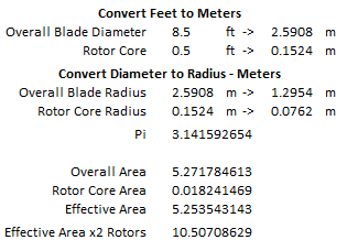

Ok, I understand the conversion to N and the static air density. However the disk area of 4,6670 sq m confuses me. An 8.5 foot diameter rotor (per) converted to meters 10.507 m^2.

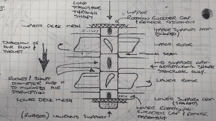

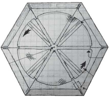

Here are a couple sketches of my design direction, please forgive the look...
The first pic is a top-down ortho of the platform's concept. The central air chamber and top blades are displayed, as well as structural support arms.
The second sketch is a (not to scale) concept of the centre support axle
A diameter of 8,5 feet = 2,59 m, then radius = 1,2954 m. and area = pi *r2 = 5,27178 m2
You substract the central 8 inches, dia. = 0,2032 m, then r = 0,1060 => area = 0,03243
So, it's really a net area of 5,23935 m2
It's only the swept surface of the system that counts here, because the approximate calculation of the momentum assumes a mass of air flowing through a given area. How you achieve that flow is not pertinent...
Repeating the calculation with 5,239 m2
=>P = 4445 * sqr [4445/(2 * 1,2250 * 5,239)] = 82,7 kW = 111 hp...
It's somewhat less than in the earlier calculation because using larger rotors is 'cheaper' in terms of power: for the same change of momentum you need less power.
