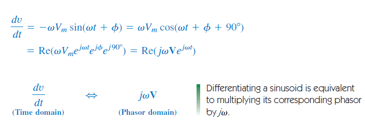

The textbook says that differentiating a sinusoid is the same as multiplying the phasor by jω. Shouldn't jω be jωejωt?

No, you start with Re(Vejωt),
and differentiating gives you Re(jωVejωt). :wink:

The book asserts that if V1 and V2 are phasors that represent v(t) and dv(t)/dt, respectively, then they are related by:
V2 = jωV1

No, it asserts that [tex]\frac { dv}{ dt } \leftrightarrow \overrightarrow { V } j\omega[/tex]
(You can't have dV/dt anyway, since V (the "complex voltage") is a constant! :wink:)

[tex]So\quad \frac { dv }{ dt } =\overrightarrow { V } j\omega \quad is\quad right\quad and\quad \frac { dv }{ dt } =vj\omega \quad is\quad wrong.\\ How\quad did\quad the\quad author\quad derive\quad that\quad \frac { dv }{ dt } =\overrightarrow { V } j\omega ?[/tex]
You need to keep track of V and v.
They represent the voltage in different domains: one is real and the other complex, and they never "live" in the same space. Hence, they are not the same thing.
Phasors is just shorthand. What you are "really" doing is applying a Fourier transform to a differential equation. This is not something you have to worry about as long as you keep the usual rules for phasors in mind, but it helps explain why V and v are fundamentally very different.

No!
As both milesyoung :smile: and I have said, V is constant.
dv/dt is not constant, it's sinusoidal, it can't equal jωV.
Your book doesn't say =, it says ##\leftrightarrow##.
The v and V methods are completely different and incompatible (see the link above).

= means that the LHS and RHS (as f95toli :smile: says) "live" in the same space.
##\leftrightarrow## is used to show that the LHS and RHS are completely different, but that they represent the same thing.
