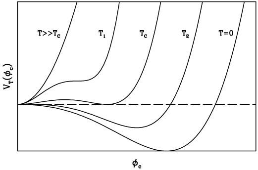

Hello,
I have read that above a certain temperature, the weak bosons become massless and become indistinguishable to the photon. Is the idea simply that at high enough energies, the Higgs field can sit on top of the peak in the mexican hat potential? I.e. at high enough energies, it's vacuum expectation value can be 0 (even if that were the case, surely it would still "prefer" to sit in the brim)? Would the leptons then also become massless?

That's exactly right. The Higgs potential contains temperature-dependent terms that "restore" the symmetry at temperatures above the critical temperature of the phase transition: see
No, not exactly right. The OP thinks that the Higgs field would be sitting at the top of the hat - that is in a meta stable state. That's not what happens. As your own figure shows, at a temperature above the critical temperature, there is no hat.

I don't see the problem with a mildly negative lambda. At high temperatures, the finite temperature terms (that go as [itex]\sim T^2\phi^2[/itex]) tend to dominate unless lambda is strongly negative. I don't know how strongly negative off-hand, but I recall that the theory goes non-perturbative anyway before this happens.

In principle, yes, the Higgs mass is temperature dependent.
