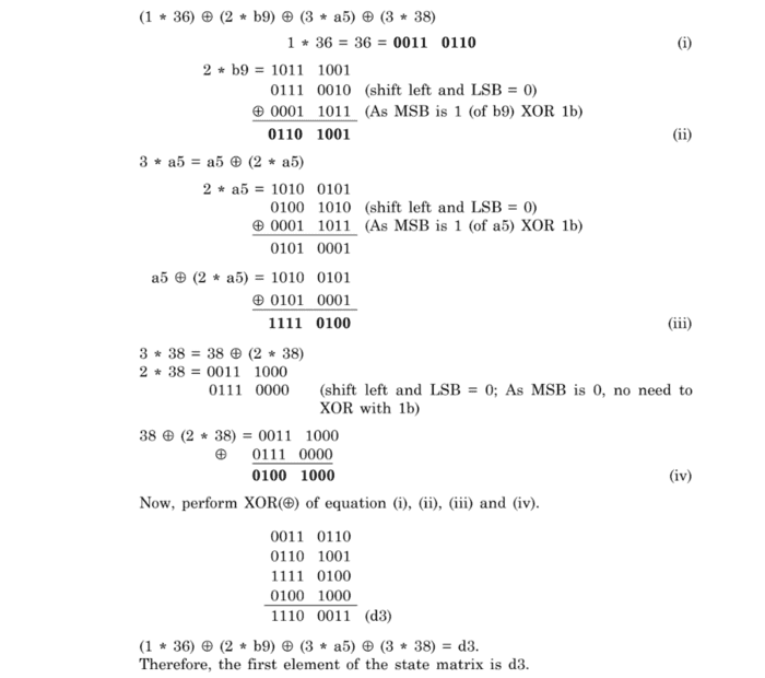

PS another question:
Handwritten-style worked example of AES MixColumns multiplication in GF(2^8): binary XOR steps for (1 * 36) XOR (2 * b9) XOR (3 * a5) XOR (3 * 38), concluding the first state element is d3.
I'm getting the result as E3 using my networkdls pdf method. Can you check the results?
(1*36)⊕(2*b9)⊕(3*a5)⊕(3*38) = (1*h'36)⊕(2*h'b9)⊕(3*h'a5)⊕(3*h'38)
This is performing arithmetic multiplication "*" by constants of 1, 2 or 3.
Binary multiplication can be seen as a shift and add operation.
(1 * x) = x
(2 * x) = x + x = (x shifted left one bit). Where "+" is arithmetic addition.
(3 * x) = x + x + x = x + (x shifted left one bit).
Once the arithmetic addition is done, the 4 terms are merged using bit-wise EXOR.
You are correct; b'1110 0011 = h'E3.
They make an error in the binary to hex conversion in the last line.
