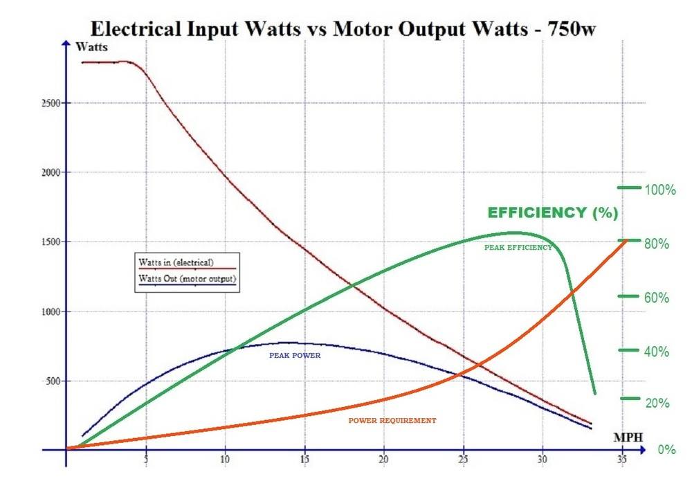

Let me help you visualize the concept, looking at the following figure for a motor for an electric bicycle:
The orange line is the wheel power, i.e. what you actually need. Usually the sum of the rolling resistance, aerodynamic drag, etc.
The blue line is the actual motor output. Where it meets the orange line is where the acceleration is zero. Thus it represents the maximum possible speed (25 MPH, in this case).
The red line is the actual electric power required by the motor. You can see that at low RPM it is really inefficient to convert its electrical power to mechanical power.
The green line is the motor efficiency, i.e. the blue line divided by the red line. Note how in this case, the peak efficiency is past the maximum speed, i.e. it will never be reached.
Normally, you would want your vehicle to be driven in the region between peak power (for best acceleration) and peak efficiency (for cruising speeds). Imagine this motor used on your vehicle with a top speed of 15 MPH, you would constantly be at very low efficiency (wasted heat). And the fact that in that speed range you have so much more power than you need (compared to the orange line), it might even be less efficient since you will have to constantly reduce the motor power output by a large amount (say, cruising at 10 MPH).
But if you would use the same motor with a gearing factor of 2, the orange line would remain the same, but all other lines would shift to the left. So peak power would be at around 6 MPH and peak efficiency would be at around 14 MPH. The blue line would cross the orange line at around 17 MPH, i.e. the new maximum speed.

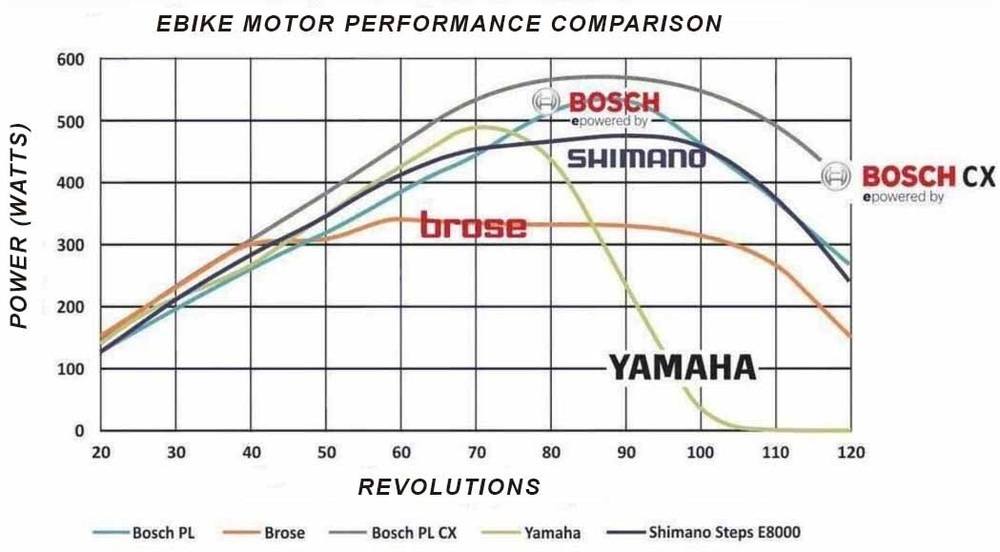

Here is another similar graph for bicycle electric motors:
You see that for any company, they have their peak power in a similar RPM range, because it matches the efficient human cadence range (60-110 rpm).
