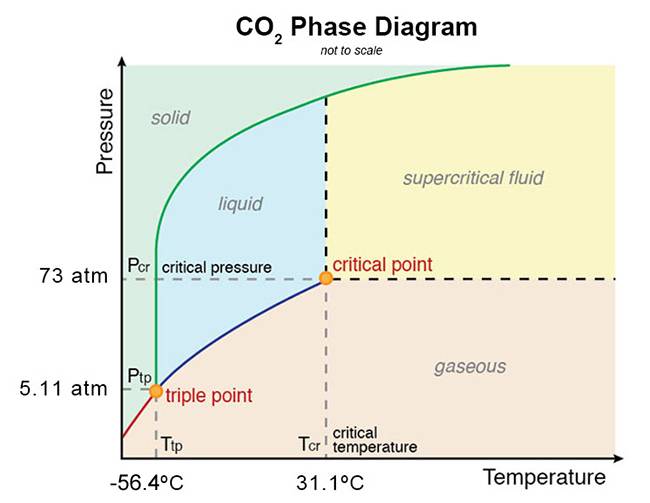

I was wondering if it is possible to have a breathable atmosphere at a sea level pressure of 6 atm(in other words, 6 times Earth's sea level atmospheric pressure).
Why am I asking this?
Well I know that above 5.11 atm, CO2 is past its triple point and thus it will become a liquid instead of going straight into a gas. Since at the critical point, the temperature is 31.1 degrees C and the pressure is 73 atm, this gives a wide range of temperatures and pressures for liquid CO2. Here is the phase diagram:
At 6 atmospheres the CO2 will be liquid between -56.4 and -53 degrees C. So during the winter at the poles, there could be temporary CO2 lakes as the CO2 rains out of the sky. I see no problem with bacteria evolving to thrive in CO2 lakes and become spores when there either is too little CO2 or the temperature gets too hot or too cold for liquid CO2. After all, bacteria on our planet have evolved to thrive at extremes of hot and cold, extremely anaerobic environments, etc.
This could be a natural process against global warming because then you have less CO2 each year than would be predicted simply by adding emitted CO2 to pre-existing CO2 because that extra CO2 would be sequestered by the bacteria in CO2 lakes at the poles and also by plants and photosynthetic bacteria in temperate and tropical climates
But back to my question. Is it possible to have a breathable atmosphere at a sea level pressure of 6 atm or is that air pressure simply too high to be breathable, even with an Earth life compatible percentage range of gases?

Certainly, that would be breathable for a short amount of time, and the CO2 would be almost irrelevant. For prolonged exposure, oxygen toxicity would be a problem for a large portion of the population, and nitrogen narcosis would be a problem for another segment of the population. But I think that the CO2 exposure would be below the danger threshold for anyone.
I can't answer the question of a breathable atmosphere, but I can tell you that, at ground level, the partial pressure of CO2 is only 0.0004 bars. If you compressed the air 6 x, the partial pressure would "soar" to 0.0024 bars.

To get stable CO2 lakes your CO2 partial pressure has to be at least 5 times the atmospheric pressure. It is not sufficient to have a total pressure higher than 5 times the atmospheric pressure. The CO2 would be toxic within minutes - basically as long as you can hold your breath because breathing would just kill you faster.
It is possible to have a breathable atmosphere at 6 times the atmospheric pressure. Trimix is a common choice, helium together with nitrogen and oxygen to keep the partial pressures of nitrogen and oxygen low. Divers can live for weeks under these conditions, and probably longer if necessary. More than 60 bar have been tested, but they don't look safe for longer periods of time.

I thought it was simply air pressure along with temperature that determined whether a certain gas goes into its liquid state or not. And like I said, at 6 atm, CO2 would only be liquid between -56.4 degrees C and -53 degrees C. So wouldn't simply compressing air that has a small amount of CO2 in it to 6 atm cause the CO2 to rain out as it condenses into liquid CO2 as long as you kept the temperature of the air between -56.4 degrees C and -53 degrees C? And well a CO2 lake at an air pressure of 6 atm, could only be stable in the polar regions. In fact, I don't think CO2 would rain out outside of the polar regions unless the clouds were so high up and even then, it would quickly evaporate back into the atmosphere. I don't know what the vapour pressure of CO2 is according to temperature and air pressure.
As you have been told, it's not. It's the partial pressure.
Partial pressure can be a hard idea to get hold of but it's all about the sum of all the gas molecules of each gas with it's own 'contributing' (= partial) pressure bashing into the walls of its container. All the momentum changes add up. If you condense most of the water vapour in a steam engine cylinder, all that you are left with is the partial pressures of the water at room temperature and of any gases that happen to be left in there - which could be very low. Mr Newcomen got it right.
As an everyday example: Temperatures on Earth are (basically) always below the boiling point of water at atmospheric pressure, but you don't see the humidity condensing everywhere. It can happen, but only at low temperatures when the partial pressure is above the equilibrium pressure at this low temperature.

Is it possible to have A breathable atmosphere at 6 Bar? Yes, but not composed of Earth's atmospheric gases compressed to that level.
