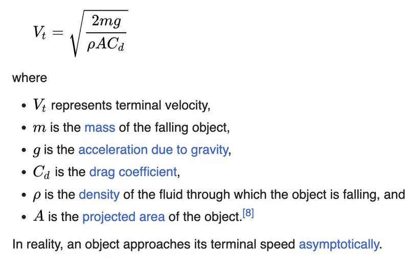

the terminal speed of a skydiver in a belly-to-earth (i.e., face down) free fall position is about 55 m/s (180 ft/s).
This speed is the asymptotic limiting value of the speed, and the forces acting on the body balance each other more and more closely as the terminal speed is approached. In this example, a speed of 50.0% of terminal speed is reached after only about 3 seconds, while it takes 8 seconds to reach 90%, 15 seconds to reach 99%, and so on.
From here.
But you can go three times as faster if you try to minimize air resistance (something that would only be done by suicidal people and by high school students who think that they are immortal).
You are at about 95% of terminal velocity after a fall from a height of 450 meters on Earth. 55 m/s is about 200 km/hr. The terminal velocity formula, from the link above is:
So, terminal velocity would be the square root of .33 relative to terminal velocity on Earth (i.e. about 57%) assuming that centrifugal force is entirely comparable to gravity (which it isn't, but it's not a bad first order approximation). This would give you terminal velocity of 31 m/s, which is easily reached from the center of the enclosure, which is plenty fast enough to kill you.
