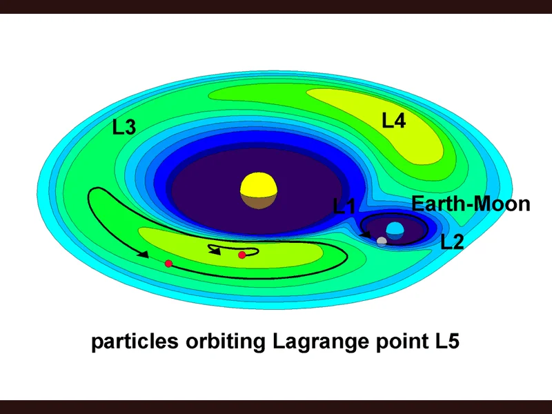

I created this diagram many moons ago
But it has only hills, no saddles.
I guess that is because it is a static diagram. I guess to see the saddle effect, it would require a velocity variable.

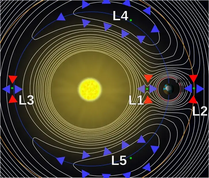

A.T. said:
L1 L2 L3 are saddles. Only L4 L5 are hills. Here a clearer diagram:
From: https://en.wikipedia.org/wiki/Lagrange_point
Right. I see now.
(That is, by the way, the very diagram (or almost identical) from which I constructed my own diagram. I separated each contour and offset it vertically by a few pixels and shaded them).
And yes, I see the saddles in my own diagram, now that I'm concentrating on L1, L2 and L3.
