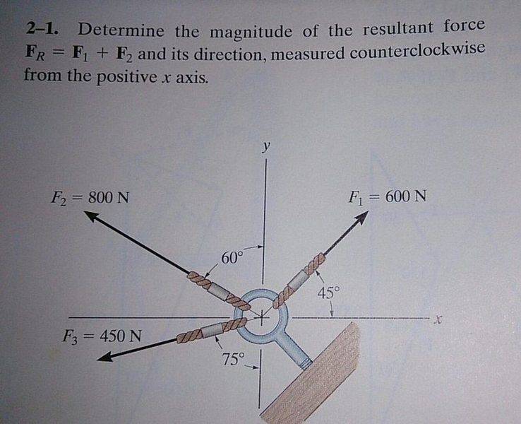

I have Fx = -800sin60 + 600cos45 -450sin75=-703N
Fy= 800cos60 -450cos75 + 600cos75 = 707.8N
FR = 997N , but te ans given is FR = 867N , is my ans wrong ? or the given ans wrong ?
In the statement only the resultant force of F1 + F2 is requested - maybe that's where the difference is coming from.
