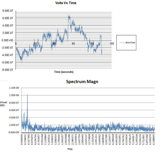

The figure below shows what a typical plot of DVM sampled data looks like:
I would of thought that a rough estimate of the 10Hz noise would be the equivalent "thickness of the line" on the top graph?
I guess my main question is why I can't sub-sample as I am doing? Why is it not a valid method. I need this explained to me in laymans terms.
The problem is that you can't tell if you are sampling a waveform at the same place on the waveform each time you sample.
If you sample at a low point each time, you could get an abnormally low reading, for example.

To find the internal noise level I think you should find the RMS of all your samples with a zero volts input.
I have zero volts input at the moment, I have a short across the input terminals of the DVM. I think you mean post process the data to get rid of any DC offset? This is kind of difficult as its varying positive and negative, but its doable. Thanks again. J
A digital voltmeter takes an instantaneous sample-and-hold "snapshot" of the incoming waveform and then goes through an integration process to work out what the voltage is.
So, your DVM may be taking 1 μS snapshots and then not looking again for 150000 μS.
You have no way of knowing what happens in that other 150000 μS.
There is also no reason to say that this 1 μS snapshot will capture a peak in that time slot. It is just a snapshot and it may or may not be a minimum, an average or a peak value.
It certainly won't somehow affect the next reading.

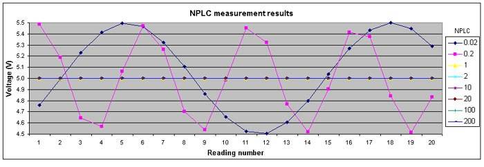

I have done this before. Unfortunately I cannot find the result but I remember conducting 2 tests; both tests involved connecting a 50Hz signal generator to the 8 1/2 DVM. The NPLC was set to 4, the reason for choosing 4 power line cycles is because we are trying to measure low frequency noise from 10 Hz to 0.5Hz. When the NPLC is set to 4 the DVM will only attenuate the 10Hz signal by a negligible amount, if the NPLC is greater than 4 then the attenuation on a 10Hz signal starts to become noticeable. If you were to change the NPLC setting and keep the frequency constant here is what happens:
A 60 Hz sine waveform 1V p-p 60 Hz ac voltage with 5V dc offset. The results show the voltage measured for each NPLC value across 20 readings.
sophiecentaur said:
Without this assurance, how can you tell that the noise signals that your varying samples contain are, in fact, the in band noise you are looking for?
Because I am evaluating the voltage samples in a time interval across the whole 2 seconds (0.5Hz) and because it is random noise (non periodic in nature) the peak-to-peak voltage will occur at different places within that 2 second interval of voltage data. I am saying that if the peak-to-peak voltage, REGARDLESS* of where it takes place in that 2 second time interval, is greater than the sub-ppm resolution that my measurement system is aiming for, then I know that the noise floor of the DVM is too much.
*As the noise data contained in that 2 second interval will be random the max and min will could occur anywhere in that interval. The excel code evaluates all the data points gathered in that 2 second interval to find the max and min. So for a 2 sec interval it will evaluate 25 (2/0.08) samples to find voltage max and mins.

Quote by sophiecentaur
And your reply:
Because I am evaluating the voltage samples in a time interval across the whole 2 seconds (0.5Hz) and because it is random noise the peak-to-peak voltage will occur at different places within that 2 second interval of voltage data. I am saying that if the peak-to-peak voltage, REGARDLESS of where it takes place in that 2 second time interval, is greater than the sub-ppm resolution that my measurement system is aiming for, then I know that the noise floor of the DVM is too much.
I think you have missed my point completely here. Once your subsampling had 'folded down' the original high frequency information it is mixed in with the wanted. in band information and no amount of averaging out will get rid of it. A spike from a 30Hz signal will look the same as the spike from a 5Hz signal to your analysis.
I'm not sure that I see a connection between the measurements you say you did with a simple frequency response measurement which I was suggesting, in effect.
I also have a problem with your use of peak noise. The DVM and the HV power supply can be producing random noise spikes. If you know (or assume) the amplitude distribution of the two forms of noise then cannot the statistics of an occasional DVM noise spike be factored into the appearance of noise from your power supply to arrive at a measure of the significance what you are measuring? It's surely statistics that you are dealing with and if you have enough mass of data, you can find out how significant the power supply contribution is to the data fluctuations, compared with the DVM. Number of 'spikes' with and without an input would be a simple comparison, for instance.
If the power supply is DC, then I am surprised that you didn't AC couple to it to find your noise. You could have been operating way above the DVM noise floor - particularly if you had used a suitable amplifier. But that's water under the bridge, of course.
So when I am evaluating to see if my DVM can permit measurements of my desired resolution at 0.5Hz I need to look over the entire 2 second interval (1/0.5) and say "If a noise signal of 0.5Hz or GREATER occurs in the 2 second interval AND the peak-to-peak voltage is greater than what my system specification calls for, then the DVM is not suitable for not capable of achieving my desired measurement resolution at 0.5Hz and GREATER frequencies (the greatest frequency being 12.5 Hz)"
Sorry I posted this without reading your last comment. But does what I said above^ make sense ? I will try and get my head around what you just said...please bare with my "slowness" in this subject area.
Reading this makes me wonder how you arrived at a 'desired measurement resolution' defined in this way. The nature of noise is that it tends to be random and there is no 'maximum noise pulse amplitude'. (Of course, once amplified, there is always the limit imposed by the system supply volts, but that's not relevant). The reason that noise is usually specified in terms of its RMS value is that it can be measured relatively quickly and reliably (you don't need to wait for a particularly high peak and, even if you did, you wouldn't know that was the highest one likely to occur).
I am wondering how you could best specify the 'noise performance' of your HV supply and how to modify what the DVM tells you, in the light of its own noise performance. It strikes me that you are after something more akin to 'error rate' in a simple digital system, where what is of interest is the statistics of the number of times a 0 becomes a 1 and vice versa. In that case, when the noise is 'well behaved' (e.g. Gaussian) the statistics come straight from the RMS value and, if it's not, you need to look further and do actual error measurements. If, in your case, you can decide on an acceptable level of noise spike, below which the system 'works' and above which it 'fails'. Then the average rate of DVM 'errors' (input just terminated) can be subtracted from the rate you measure when connected to the PSU to give you a good idea of what the PSU is introducing. The advantage of this method is that you have all the data for this and you can easily vary your decision level. The only problem is that you cannot be totally sure about the possible effect of the sub sampling.
Could you say what the effect of PSU noise has on the equipment it's supplying? Presumably we'd be totally in the 'non-sampled world' for that.

Ok I will try and break it down what I want to achieve. I would be grateful if you could verify if this methodology is valid.
sophiecentaur said:
Your noise level is specified using a combination of frequency domain and time domain and I think that needs care. Are you doing some FT on the data to reveal the frequency components? You seem to be involving the amplitude of a frequency component and referring to the 'peak to peak' voltage. Depending on the phases of the components, the peak to epak voltage could vary (?).
I thought about FFT'in the data, but the customer requires that the resistive divider measurement system permit measurements of better than 0.2ppm of PS noise. The output voltage of the resistive divider is 10V, the input PS under test voltage is 15kV. Thus and order of magnitude below 0.2 ppm is 0.2uV. In addition the customer is specifically focused on low frequency noise and drift. They really don't want to see the resistive divider or DVM producing low frequency noise, which is defined as frequencies between 0.5Hz and 10Hz or drift, which is defined as 0.5Hz and below. They are not to bothered about high frequency spikes as these effect the mass spectrometer readings less.
N.B The customer is VERY strict, they say that even if the resistive divider or DVM produces one rogue reading that is greater than 0.2uV then the project can not go ahead as they will not be able to distinguish between the noise being generated by the PS or that being generated by the DVM or resistive divider.
The rationale for the way I am processing the data is this.
1. The DVM integrates over a number of power line cycles. In this case I have set the DVM number of power line cycles (NPLC) to 4, thus it is integrated over 0.08 seconds (1/50Hz*4). I have to set the DVM to 4 - assume this cannot be changed. This means that the DVM samples every 0.08 seconds or at 12.5Hz.
2. Now I want to first test the performance of the DVM to ensure that its internal noise is an order of magnitude less than 2ppm, i.e. I want to see if the peak to peak at a given frequency is less than or equal to 0.2uv. To do this I short the input terminals with copper wire. I take a series of measurements with the DVM with the NPLC set to 4 and see that there is noise and drift present from a voltage against time graph. Now I admit I don't know where that noise came from, was I "unlucky", did the DVM sample at the same time a high frequency spike occurred (but the spikes should be "integrated out" anyway by the NPLC setting), or was I "lucky" and the DVM missed all the spikes and only sampled at "quiet" times in the measurement? Either way I have repeated the measurements enough times to be confident that what I see is CONSISTENT i.e there is nothing "odd" on any of the graphs.
3. Ok so each time perform the measurement the data looks similar by eye i.e there is no spurious spikes of ultra quiet readings despite the voltage Vs time graphs randomly varying with the internal noise of the DVM. So I know that there is a good chance that the DVM is producing noise and order or magnitude below that of what the specification demands.
4. Now the customer is particularly concerned with low frequency noise between 0.5Hz and 10Hz and drift below 0.5Hz. Now first let's JUST pick on the noise between 0.5Hz and 10Hz. So I look at my data and say "for each 2 second (1/0.5Hz) interval that occurred did a peak-to-peak voltage occur that was greater than 0.2uV?". Now let's swap the notion of a non-periodic noise signal for a periodic sine wave so it makes this easier to imagine. Let's say the sine wave has a period of 1 second (1Hz) and a peak-to-peak voltage of 0.2uV . The excel sheet comes along and says "for the first 2 seconds worth of data, Sample 1 to Sample 25 (25 samples because 25=2 seconds/0.08seconds), did the peak-to-peak voltage go above 0.2uV?". To answer this question it searches for the maximum voltage value, then the minimum voltage value in samples 1 to 25, and subtracts them from each other. Let's say that the DVM samples the wave when the positive and negative amplitude is only at 0.05uV giving a peak-to peak voltage of ONLY 1uV i.e within spec. 5. Dam it! We have missed the REAL max and mins of the sine wave. However all is not lost, the excel sheet shifts up a block of 25 samples so it now evaluates samples 2 to 26. It might still miss the maximum and minimum voltage. However if it continues this process it will eventually find them! Once it finds them we can say whether or not the specfication that the customer wants is possible with the DVM we have (If the DVM isn't capable of the measurement then its pointless going any further).6. Ok so the Excel sheet has eventually found the REAL/MAXIMUM peak-to-peak amplitude of 0.2uV. But at what frequency did it occur? Can we tell? Well I know that because I sampled and evaluated a time interval of 2 seconds that the frequency of the wave must be between 0.5Hz and 6.25Hz and this happens to be a BW that the customer is particularly interested in. Remember when I said they define low frequency noise as 0.5Hz to 10Hz. (The reason why its 6.25Hz is because this is half the frequency of the sampling frequency 12.5 Hz i.e. the highest frequency that I can subsample, a 12.5Hz signal should get integrated away the fact that the NPLC is set to 4 on the DVM).
7. So I can go back tell the customer that I measured a REAL/MAXIMUM peak-to-peak voltage amplitude of 0.2uV, I know that this signal must be between 0.5Hz and 6.25Hz because I evaluated all the sampled over 2 seconds. and this 2 seconds will include all the data that contains signals from 0.5Hz to 6.25Hz (the limit of the DVM). I know that these are the frequencies that you are most concerned with and I know that if you spot this occurring even once over the measurement it will shake your confidence in the ability to fulfill the specification, thus we can/cannot go any further with this project. I hope you can follow what I am trying to achieve.
Thanks a bunch!
J
My first response is that they haven't asked for a meaningful measure of noise. Noise needs to be specified as RMS in a given bandwidth or some other measure of the statistics. I suggest that they may feel that they are being "strict" but they may not be as well informed as they think they are. You should ask them for clarification, I think.
This all involves exceptionally low frequencies but the same basics of noise and error statistics still apply. (How can it not be so?)
The output of your DVM is only a set of samples of amplitude in a time window of 2s. There is no assurance that, just outside this window, there is not a noise spike that exceeds any sample in your set. There is no assurance, either, that any spikes you see don't correspond to a very sharp spike that has virtually no energy at all in-band but your sampling circuit has happened to pick it up (unless your input signal is specifically band limited.
You really need to read something about the nature of noise and sampled signals before you can proceed further, I'm afraid. The good news is that I don't think your customer knows any more than you do!
Your conclusion point 7, is surely in error. You have a set of time domain samples so you can't say anything about the frequencies involved unless you know about the pre filter. For all you know, the noise waveform you are seeing could all be due to out of band components in the original signal. Please read something about sampling theory and why pre-filtering is essential.
