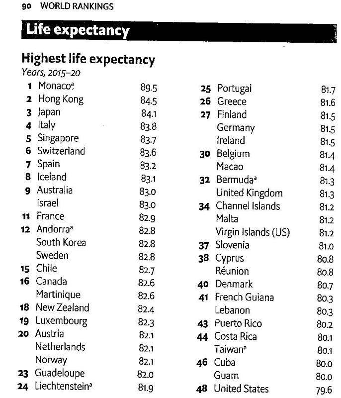

How useless then. I mean, when am I exposed to ionization beams except at the dentist, or in a hospital? Who wants to know their exposure during flights or on winter vacation?
Well, if it's a ski vacation, make sure to wear sunscreen -- it won't measure that ionizing radiation either.
That wasn't my point anyway though; my point was the OP didn't seem to notice the word "radon" and was fixated on the Geiger counter being contaminated. Fearing the Geiger counter, not the [potential for] deadly gas in the basement.
There's such a thing as rational fear or concern. It's the kind that you develop through thought, logic and learning, not by daydreaming and wildly speculating about what can kill you. Because pretty much everything can kill you if you use it wrong enough. So you have to put real thought into what to be concerned about/fear.
