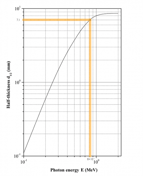

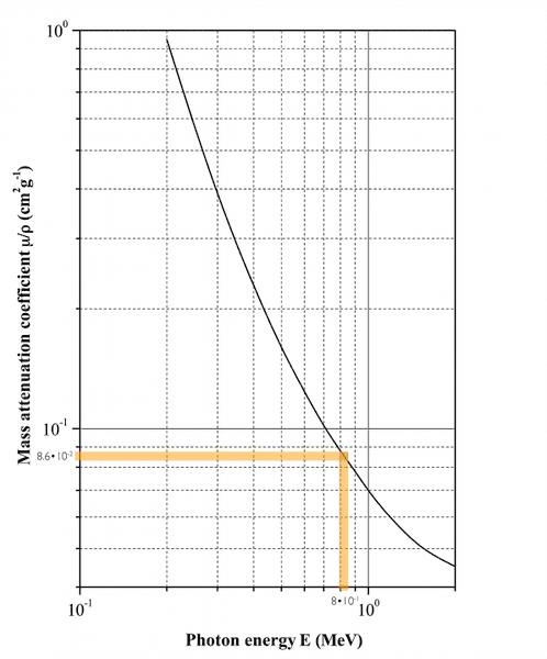

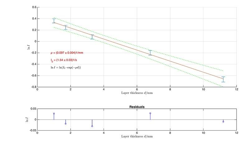

Hi everybody! My homework this week is to discuss the results we obtained in an experiment last week, which was about determining the gamma-rays absorption coefficient of lead ##\mu## with a Geiger-counter and then read from a graph the gamma photon energy of the radioactive material caesium-137.
For the absorption coefficient, we measured the time taken by the Geiger-counter to make 1000 counts for 5 lead plates with different thicknesses and without plate, then performed a linear regression of ##\ln(I(d))## (##I## being counts/time - background level) which gave us ##\mu## (see attached pics). The background level was measured with nothing inside the compartments.
It is important to note that since we did only one measurement of ##I_0## (counts/s without plate), we could not plot ##ln(\frac{I(d)}{I_0})## because we could then not calculate the covariance in the uncertainty. We were told to do it that way and use ##I_0## as a parameter for the fit.
The thicknesses of the plates were 1, 1.7, 3.3, 6.8 and 11.2, all given in mm.
The relation between all those values is: ##I(d) = I_0 \cdot exp(-\mu \cdot d)##.
I will also give here our results: the absorption coefficient was found to be ##\mu = (0.097 \pm 0.004) mm^{-1}##. As a consequence, we found that the half-thickness was ##d_{1/2} = (7.1 \pm 0.3)##mm and that the mass attenuation coefficient was ##(0.086 \pm 0.004)##. After reading the graphs we were given (see attached pics), we determined the photon energy of ##^{137}##Cs to be ##E = (0.8 \pm 0.1)##MeV.
Also important about discussing the fit (see below), ##I_{0,parameter} = (1.54 \pm 0.03)## and ##I_{0,measured} = (1.65 \pm 0.06)##.
The problem is that the reference value I found for the energy is ##E_{ref} = 661.64##KeV, and I must now explain this non-negligible difference in results. I am in first year, that is I never had any lecture about quantum physics so I am a bit clueless. I figured that the error is most probably located in the fit, and if ##\mu## would be bigger then ##E## would tend towards ##E_{ref}##. Through research and thinking, I have some suggestions but I can't be sure whether they are right or wrong:

  • Linear fit plot of ln I against layer thickness d in mm, with five error-bar points falling from about 0.33 to -0.66, green dashed uncertainty bands, and fit text mu = (0.097 ± 0.004)1/mm and I0 = (1.54 ± 0.03)1/s; below it, a residuals plot of small deviations around zero.
  • Log-log graph of mass attenuation coefficient μ/ρ (cm²g⁻¹) against photon energy E (MeV), with a highlighted reading at about 8×10⁻¹ MeV giving 8.6×10⁻² cm²g⁻¹.
  • Log-log graph of half-thickness d1/2 (mm) against photon energy E (MeV), a rising curve flattening near 1 MeV, with orange highlight lines at d1/2 = 7.1 mm and E = 8 x 10^-1 MeV.

Where is the non-negligible difference? One more digit for the 0.8 +- 0.1 MeV value would help, but 140 keV difference with 100 keV uncertainty is perfectly fine.
I don't understand the problem you see with the I0 measurement. Just put it in the fit as value for a plate with 0 thickness?
Really? When a value lays outside the error boundaries, we usually have to find a pretty good explanation for it.
The problem does not relate to ##I_0## itself but in the calculation of the uncertainty. If we plot ##\ln \big( \frac{I(d)}{I_0} \big)##, we have to take into account that ##I(d)## and ##I_0## are correlated. Since we have only one measurement of ##I_0##, we cannot determine the covariance (we only know it lays between 0 and 1. Actually we were told pretty clearly to do it that way and have ##I_0## as a parameter. Why we measured it anyway is a mystery to me, maybe so that we can discuss the poor methodology of the experiment.
Uncertainties are usually given with their standard deviation or similar metrics - typically (~2/3 probability) the actual value should be within that range if the estimate is correct, but it can also be a bit outside. If the deviation exceeds two standard deviations, things get more interesting. Absolute error bounds ("there is no way it can be more than that") are rare because you are never absolutely sure about any measurement.

Where do you expect a correlation? In particular, which correlation do you see that would not be present between the different I(d) values?
You can have I0 as free parameter in the fit and still plug in your measurement of I(0).
Okay good to know.
You're right, I didn't get that until now. I'm going to add ##I_0## as ##I(0)## in the fit. About the correlation, I would think that if the components of the fit are parameters, then they are not correlated. I might be wrong though, but the guy wrote ##ln \big( \frac{I(d)}{I_0} \big)## barred on the board so I don't really want to challenge him. :DD

It is possible to use those ratios, but (a) the values are not correlated in a relevant way and (b) not dividing the counts is a more natural way to fit the data. Diving all by a constant doesn't change the fit result in any way.
