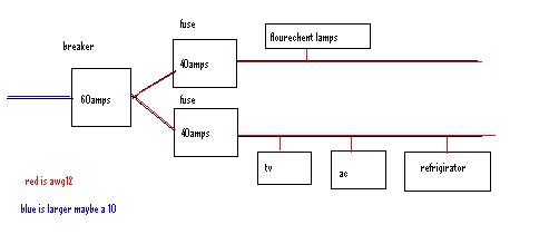

chrisalviola
80
My parents house use to have 40amps fuse and awg12 solid wires on all the house wirings, including 1x 1/2watts ac, 1x ref, 1x 20inch crt tv, 10x large florescent lighting, 1x pc with 300watts psu and maybe some ironing once a week, i changed the main fuse box to 60amps breaker thinking its enough, the main breaker is still connected by 2 sets of 40amps fuses the first set is for the lighting and the other is for the ac and refrigerator, the breaker is connected now and i recently checked some websites and it says that if your have 12awg you need atleast 30amps of fuse, so you think my 60amps breaker would still trip off?

I'm thinking your "1/2watts ac" refers to 1/2 ton (6000 BTU). Most 1/2 ton air conditioners will require around 5 to 7 amps at 115volts. If you are having problems "blowing" fuses, then for sure you don't want to just up the fuse size in your case. The rated ampacity of 12 gauge solid copper wire is, according to the National Electrical Code, 20amps. The best solution is to either add another 20amp circuit or split the loads (move something to another outlet). As MATLABdude says, "there's the possibility that the insulation or conductor itself could get hot and/or melt and/or start a fire!"

my current setup
what do i need to change? here any suggestions?
Can you confirm that the TV, AC and refrigerator are all daisy-chained together (meaning that it's a single cable coming back to the box, instead of a bunch of cables that are tied together through a bus bar or with wire nuts.) I'd have to advise you to actually down-grade both fuses to 20 A ones. You want the fuse to blow instead of allowing your wiring to burn up. That or rewire some of these onto different circuits (each fluorescent tube, for instance, only uses up 1/3 A or so, neglecting the ballast).
If this is a feeder panel, and the blue wire is ten gauge (check the jacket), you should use a smaller breaker at the main panel (or at the top of the feeder), probably a 30 A one, and not the 60 you have.
The important thing to remember is that a 20 A fuse (or 20 A breaker) won't blow the moment it hits 20 A; they're designed to blow depending on how much more current they're carrying than they should. If it's 200%, it'll probably blow fairly quickly. If it's only 125%, you might have half an hour. If it's right at 100%, it probably won't actually blow.

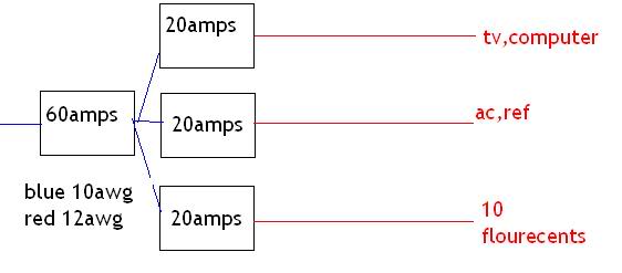

thanks for the advice i will replace my 40amps fuse with 20amps breakers i will do that when i visit my parents house.
just went to the hardware and bought 3x 20amps breakers and some 12awg's
i want to setup these in my parents house, is this schematics ok?
That looks reasonable--I'm glad you didn't have to pull extra wiring to split the circuits like this. I'm a little confused as to how you have 10 gauge wire between the 60 and 20 amp breakers, though. What brand / model are the breakers? All the breakers I'm familiar with plug or screw into the breaker panel.
EDIT: Nevermind, it looks like you are running extra wiring. If you've never done that sort of thing before, please, please consult a home wiring book or better yet, someone that's done this before. On the other hand, 20 A breakers with your current setup would pobably still work.
Yes, having done it before, I'm distinctly not a fan of ripping open walls and running wiring. Suspended ceilings aren't too bad, but you still usually have to run into walls.
Looks good chrisalviola. It's nice that you took the time to check out the details. Now all you have to do is be careful and double check that anything you are going to touch is not energized.
