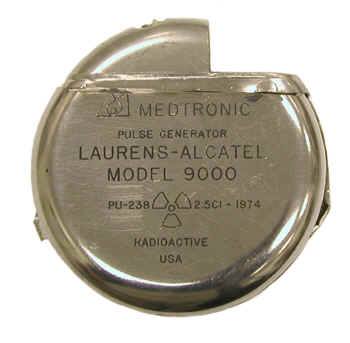

RTG-powered pacemaker with plutonium:
2.5 Ci * http://www.nndc.bnl.gov/chart/reCenter.jsp?z=94&n=144 = 680 milliwatts
Oak Ridge: Plutonium Powered Pacemaker (1974)

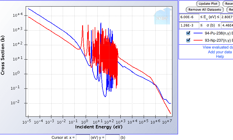

Actually, I wonder, for thermo-electric generators powered by Pu-238, does one do an isotopic separation on the plutonium to get pure Pu-238 ?
Good question. If Pu-238 is produced from Np-237(n,gamma) (Np-238 beta decays), and it seems that Pu-238 has a much higher (n,gamma) cross section than Np-237 in the thermal spectrum (looking it up on NNDC), then it would make sense that "Pu-238" created in light-water thermal reactors would actually be mostly Pu-239. But I've never heard of hot-cell isotopic separation - uranium enrichment is of course very low-radiation stuff. IIRC Kirk Sorensen claimed that it's next to impossible, in the context of proliferation and the thorium fuel cycle, where short-lived U-232 contaminates fissile U-233.
:confused:
Ah, that's it. First, Np-237 is extracted from nuclear spend fuel, and then separately re-irradiated in a neutron flux.
You can work with low production fractions, and then the production rate of Pu-238 (proportional to the density of Np-237) is larger than the production rate of Pu-239 (proportional to the density of Pu-238), like they do in production reactors for Pu-239 (with U-238 this time). If you only convert, say, 1% of the Np-237 into Pu-238 before separation, you get pretty pure Pu-238.
