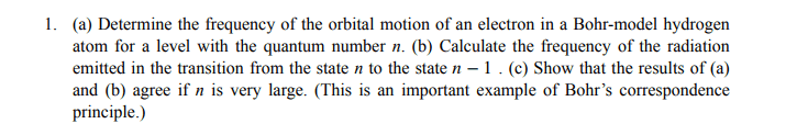

(a) Determine the frequency of the orbital motion of an electron in a Bohr-model hydrogen
atom for a level with the quantum number n. (b) Calculate the frequency of the radiation
emitted in the transition from the state n to the state n-1. (c) Show that the results of (a)
and (b) agree if n is very large. (This is an important example of Bohr’s correspondence
principle.)
Rydberg formula, mvr=nh_bar
So for this question I just want to make sure that
1. Bohr model is that F_coulomb = F_centripetal? and then get w(r) is called determind?
2. for (b) calculate the frequency, should I use Rydberg formula or what?

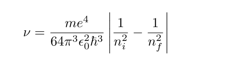

Do you think is this what problem asks and is it right? also it seems have missed a 1/2 I am not sure:

Please look at the reference where you got this expression for ##\nu## and tell me what it says that it is. Is it the frequency of orbital motion of the electron when it is at state ##n## or is it something else?
Your calculation in part (a) is correct.

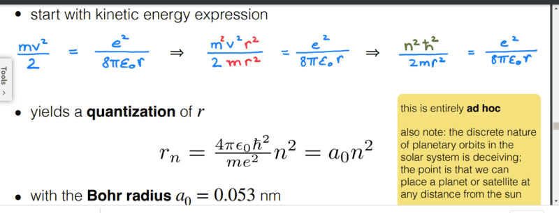

It is the frequency, this is from my quantum physics class. I will give you a more detailed, I just can't figure out why I got different than the silde:

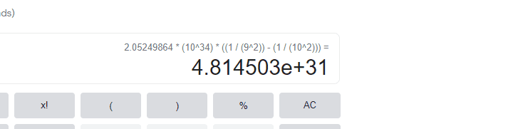

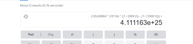

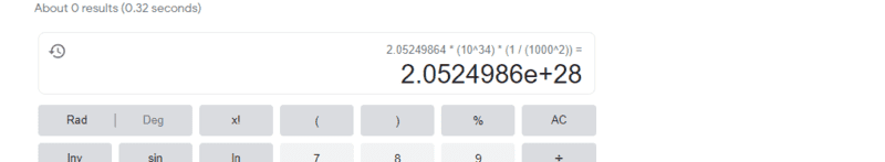

So I cannot get agreed in (c):
And the bigger n is the bigger difference it gives:

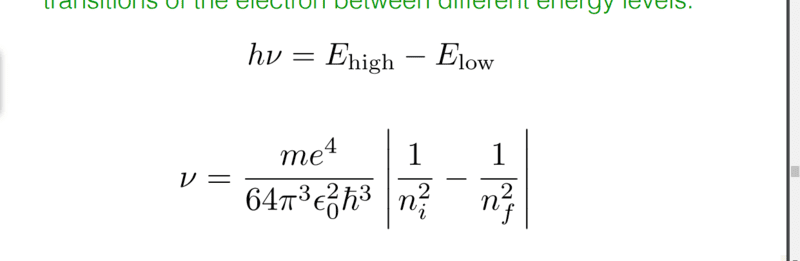

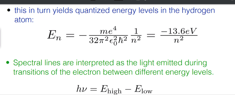

I agree, it is not the frequency of a matter wave. If you look at the derivation you posted in #7, it is the frequency ##\nu## in $$h\nu=E_{\text{high}}-E_{\text{low}}$$ Does this suggest an orbit or something else?
I think this is for radiation of Atomic electron transition frequency, which is for part(b) (just my thought)
That's exactly what it is. You have the frequency of the orbiting electron ##\nu_{\text{orb}}## that you posted in #3 as ##f## and the frequency of radiation ##\nu_{\text{rad}}## that you posted in #4. As you noted, ##\nu_{\text{rad}}## is smaller by a factor of two. Your task in part (c) is to show that when ##n## becomes extremely large, ##\nu_{\text{rad}}\approx \nu_{\text{orb}}. ## Got any any ideas on how to do that?

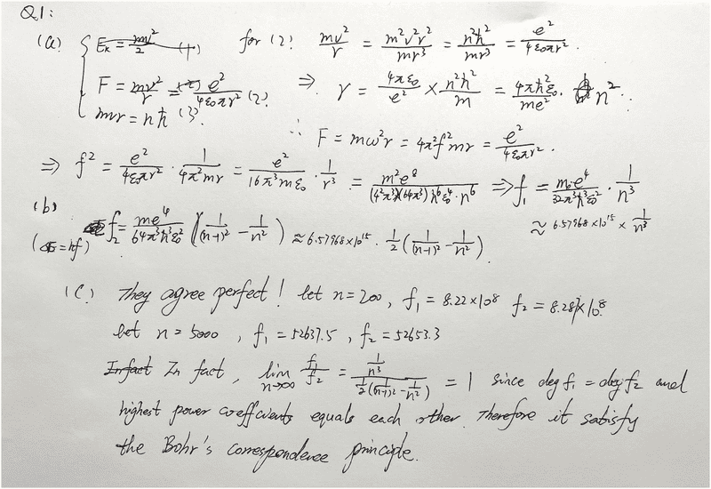

The .pdf that you attached is sideways and I cannot read sideways. Please learn to post your work in LaTeX. The link is on the lower left of the editor screen, above the "Attach files button".
What you need to do here is to verify the Correspondence Principle. I suggest that you show that the semi-classical calculation for the change in energy when ##\Delta n=1## for large ##n## yields ##\Delta E= h \nu_{\text{rad}}##. If you can show that ##\nu_{\text{orb}}\approx \nu_{\text{rad}}##, then all you need to do is show that, semi-classically, when the angular momentum ##L## changes by ##h##, the energy change is ##\Delta E=h \nu_{\text{orb}}= \hbar \omega_{\text{orb}}.## (I prefer ##\omega## over ##\nu##.)
How to do that? I'll get you started. $$E=\frac{L^2}{mr^2}\implies~\Delta E=\frac{L\Delta L}{mr^2}.$$Assume ##r## does not change appreciably (it is proportional to ##n## which is huge) and find an expression for it in terms of ##L##. What you need for ##L## and ##\Delta L## should be obvious.

Seems I did it in this way. Hope I did it right(there's a fixed pic of my pdf below)
