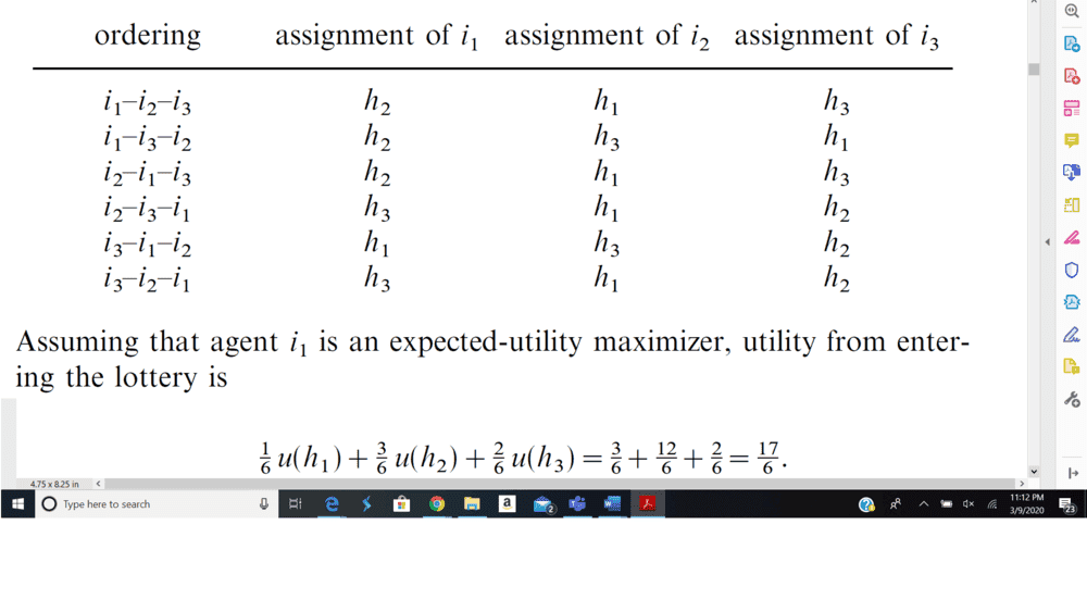

I am trying to understand a calculation in a research. I feel they are trying to calculate probability
They are doing following calculation:
1/6*(uh1) + 3/6*(uh2) + 2/6 (uh3) =17/6

I am trying to understand the calculation in the following research paper:
http://cramton.umd.edu/market-design/abdulkadiroglu-sonmez-house-allocation.pdf

According to the paper, the table of utilities gives ##u(h_1)= 3##, ##u(h_2) =4##, ##u(h_3) = 1##. The calculation shown in the paper is ##(1/6) u(h_1) +( 3/6)u(h_2) + (2/6) (u(h_3) = 3/6 + 12/6 + 2/6 = 17/6##.
For tenant 1, the function ##u## is a random variable. It has 3 possible outcomes (the ##u(h_i)##) and with each outcome there is an associated probability ##p_i## The sum of products of the form ##p_i u(h_i)## is the expected value of the random variable, which some call its average.
Please tell me how we can state this probability ##p_i## in words?
Zulfi.
Each of the 6 orderings is assumed to have an equal probability. For example, the ordering ##i_2, i_1, i_3## has probability 1/6. With that ordering, we assume tenant ##i_2## picks his favorite house, so he picks house ##h_1##. The leaves the choices available for ##i_1## to be houses ##h_2,\ h_3##. Tenant ##i_1## choses house ##h_2## since it has utility 4 to him and 4 > 1.
There are 3 out of 6 orderings where tenant ##i_1## choses house ##h_2## and obtains a utility of 4. So there is a 3/6 chance that the random variable ##u## = "utility of the result to tenant 1" is equal to 4.
##p_i## = the probability that tenant ##i_1## obtains utility ##u(h_i)##

Sorry I can't understand the fractional values 1/6, 2/6 and 3/6. How can you say that :
For example, the ordering i2,i1,i3 has probability 1/6.

The paper assumes all possible orderings of how the 3 tenants make choices have the same probability. There are 6 possible orders: (1,2,3),(1,3,2),(2,1,3),... etc.
Some possible orders result in the same utility for observer 1.
