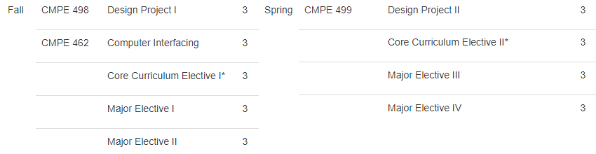

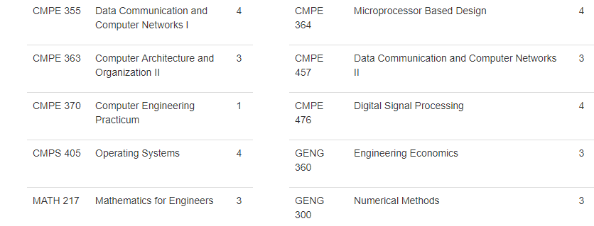

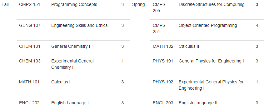

Hello, is this program "complete"? (In the sense that a math undergrad curriculum without calculus 2 wouldn't be, for example)
Year 1 :
Year 2 :
Year 3 :
Year 4 :
Major electives :
http://www.qu.edu.qa/static_file/qu...nts/Course_Description/Course_Description.pdf
For each of the 4 years listed, are all of those classes required?

Yep certainly looks like it. More low-level computing. Comp Arch, DSP etc. That's how I remember it.
This is something you should definitely be talking to a prof or guidance councilor at your uni. It is very difficult for anybody else to guide you on the total workload involved. I am presuming the numbers beside each course are the classroom or contact hours? It looks like it probably is an OK workload, but that will depend very much on the amount of homework profs typically assign, how many mid-term exams, how many extra projects, etc. and etc. Such things will be university specific. Even department specific.
One thing I noticed just casually glancing through. There is little outside of your specific area of study. It's a university, so take a look at that course catalog. Pay attention to the other technical subjects. And pay attention to the humanities. Don't automatically turn them down. But do talk to a prof about the workload. Don't add that history or philosophy class if it's going to mean you have to work 90 hour weeks. But it's likely your best ever chance to take such classes, so at least check it out.
