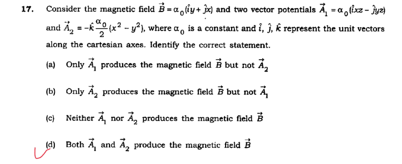

Is the Correct Option for Magnetic Field Homework Statement (d)?
Pushoam
961
53
Multiple-choice question 17 asking which vector potential produces magnetic field B = α0(iy + jx), with options (a) through (d); option (d) 'Both A1 and A2 produce the magnetic field B' is marked with a handwritten checkmark.
Using ## \nabla \times \vec A = \vec B##. I got that both ##\v A_1 ~~and~~ \vec A_2 ## produce ## \vec B##. So, the correct option is (d).
Is this correct?
