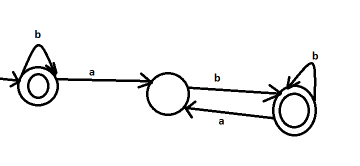

I have to construct the DFA of the language $L=\{w \in \{a,b\}^*: \text{ each } "a" \text{ of the word w is appeared only after and before a } "b"\}$.
I tried the following...Could you tell if it's right?
But is it deterministic? From the second state where do we go with $a$ ?

Re: Is the DFA of the language $L$ correct?
Immediately after and before a b, or can there be symbols between them?
This automaton accepts ab where a is not preceeded by a b..
If consecutives a's are not allowed then there should an arrow to the "sink" state that is not accepting and from which there is no escape.

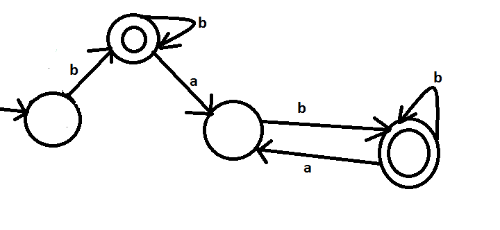

This is the pronunciation of the exercise.
What I understand is that $aa $ is not allowed but $bb$ or $bba$ or $abbb$ or $babb$ is allowed..
Am I wrong?
Am I wrong?
In general, we can only help with mathematical questions. I can't help clarify what a certain person meant when he/she devised a particular exercise, especially if there is a chance that there is a language barrier.
To me, the most natural way to interpret the exercise is that each a must be immediately preceded and immediately followed by a b.
The strings $bba$ or $abbb$ should not be allowed because a is not surrounded by b's.
Ok...I tried it again... Is it now correct?
I believe that the empty word should be acceptable because every $a$ (there is none) is surrounded by $b$'s. Also, there is still no arrow to the sink state when $a$ is read in the third state. Finally, why not make $b$ go from the third state back to the second one? Why do you need another accepting state?

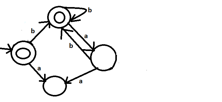

Do you mean something like that?
Yes. And the arrows for $a$ and $b$ from the bottom state to itself.
Nice! Thanks a lot for your help! :o
