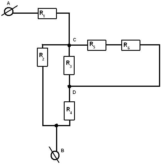

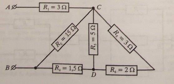

Original:
Redrawn:
Is the electric scheme correctly redrawn?
Which of the resistors are in parallel and which are in series?
It looks correctly redrawn. Now go ahead and answer the last part about series & parallel...

Yeah, that last question wasn't necessary for me. Now I don't know why I even bothered to ask it everything's clear here...
Oh and Thanks for the help.
