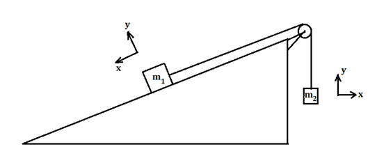

I think this is the setup
Physics diagram of two masses connected by a rope over a pulley at the top of an incline; m1 rests on the slope and m2 hangs vertically from the pulley side, with x and y axes marked for each mass.
Consider m1. What individual forces act on m1? For each of these forces, what is the x-component of the force? For m1, let's take the positive x direction to be parallel to the incline as shown above.

X component consisting of the Tension? acceleration, and net force?
Yes, tension is an appied force in the X direction, but acceleration is not a force, and the net force is not an applied force - it is the sum of the applied forces.
What other applied force has a component parallel to the plane?
