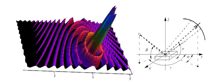

Trying to work through a paper which includes a discussion of the optical properties of crystal, and the author uses the term "indicatrix", at one point referring to it as a diagram, which makes sense, but another place referring to it as a "volume chart", which I haven't figured out. Could someone tell me what is meant by "volume chart" for the indicatrix, or whether it doesn't apply? Maybe something gets lost in translation? (The paper is in Russian; I'm translating literally.) That is my first question.
Second question: Even more puzzling is that I thought that an indicatrix was an ellipsoid, but the diagram in the paper (attached below), done on MathCad, looks nothing like an ellipsoid. Is it possible for an indicatrix for a crystal to not be an ellipsoid?
A couple more details: the caption for this diagram is
Fig. 4. Diagram (indicatrix) of particle (electron) scattering through 1940 layers of sinusoidal equipotential surfaces of a crystal, ...https://www.physicsforums.com/file:///C:\Users\DAVIDM~1\AppData\Local\Temp\msohtmlclip1\01\clip_image002.jpg https://www.physicsforums.com/file:///C:\Users\DAVIDM~1\AppData\Local\Temp\msohtmlclip1\01\clip_image003.jpg

Definitely something is getting lost in translation. I believe "volume chart" must just mean a 3D rendering. The indicatrix is usually an ellipsoid. Taking a cross section perpendicular to the direction of propagation gives an ellipse. The ellipse shows the index of refraction as a function of the direction of the electric field polarization. The slice is easy to draw in 2D, but if you want to picture the whole 3D indicatrix you have to make a 3D rendering on the page. I don't know any Russian, but I could easily imagine a translation of the Russian for a 3D graph coming out to "volume chart". Heck, that's practically the best way to say it in English if you think about it.
I can't explain the chart. That certainly doesn't look like any indicatrix I've ever seen. On the other hand I'm used to thinking in terms of light, and not electrons. I can say that for light the indicatrix can be more complicated than an ellipse. For example I worked designing lithography machines when we were trying to move to 157nm light. The optics were to be made out of CaF2. CaF2 is cubic and the polarizability should be centrosymmetric. For lower energy light the indicatrix is uniform. There is no birefringence. It was discovered that 157nm light was energetic enough to have a nonlinear interaction with the polarizability of the crystal matrix. The result was a complicated idicatrix which had the cubic symmetry of the crystal.

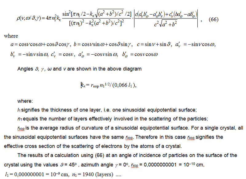

Second, you are saying that while the diagram is unusual, it is not for all that necessarily wrong. That's encouraging. The formula he is using is:
Like I mentioned, I don't know about what would be called an indicatrix for electron scattering. I've only ever heard that as an optical term. Also, while an indicatrix can be more complicated than an ellipse I've never seen anything like the complexity of that ripple structure. Finally, looking at your equation that just looks like an electron scattering probability to me. Are you sure the word indicatrix was associated with this calculation?

Ahh. I think I begiin to understand. Searching the internet I am learning that for light there are unrelated things called indicatrix ... es. (Indicatrices??). There is an optical indicatrix which is the dependence of the index of refraction on propagation direction and polarization. That is the one with which I am familiar. Then there is something completely different called the scattering indicatrix which is the dependence of scattering probability on incident direction, scattered direction, and I suppose polarization.
This suggests that "indicatrix" is the 3D directional dependence of just about anything including, in this case, the dependence of electron scattering probability on incidence direction and scattering direction.
Well, that is new terminology to me, but in any case I think what you are looking at in the diagram is the electron scattering probability as a function of incidence and scattering angles. The scattering material is postulated to be layers, so the scattering probability has symmetric rings at higher and higher scattering angle as higher and higher orders of the Bragg condition are reached.

Excellent. Thanks very much, Cutter Ketch. It now makes sense. The information and analysis are very much appreciated.
