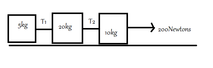

We have to find T1 and T2
From right to left objects are: A B C
F=ma
Okay. So I found acceleration of whole system:
F=ma
200N= (20+10+5)*a
200/35=a
a= 40/7 ms-2
Now, finding T1 is fairly simple:
f=ma
T1=5*(40/7)
T1=200/7 Newtons (Let's not reduce it right now to decimals)Now, T2. This is where the problem arises.
T2 can be calculated by the difference of the forces on object A.
f=ma
Force on A= 10kg*(40/7)
= 400/7 Newtons
T2 will be:
200-T2= 400/7
200-400/7= T2
1000/7 Newtons= T2
1000/7N= 142.75 Newtons.
Is this answer correct? Please tell me. I'm very confused.
Thank you for reading.

It is not clear from your description what A is, bit it seems to be the 10 kg mass to the right by your attempt.
prakhargupta3301 said:
200= T2- 400/7 (T2 is greater than 400/7 N but obviously lesser than 200 N)
200-400/7= T2
Apart from the fact that you made a sign error in the first that mysteriously disappeared in the second step, yes, this is a viable approach.
Orodruin said:
It is not clear from your description what A is, bit it seems to be the 10 kg mass to the right by your attempt.Apart from the fact that you made a sign error in the first that mysteriously disappeared in the second step, yes, this is a viable approach.
Thanks a bunch for:
a) Replying and conforming
b) pointing out the mistakes in the query.
I have corrected them.
Your method for T2 works but why not just erase mass A and the 200N force and apply f=ma to what's left.
