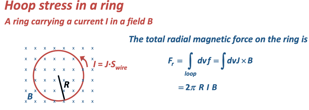

etotheipi
I was just reading through these lecture notes regarding the stresses in solenoids, and came across the following regarding a current-carrying ring orthogonal to a uniform magnetic field,
I wondered if this is a piece of terminology that I haven't come across? To me the total radial force is ##\vec{0}##; they seem to be ignoring that the radial forces (vectors!) on each small piece of the ring cancel when the integral is taken around the whole loop! I hoped someone could clarify whether you'd agree that the above is incorrect. Thank you!
The vector sum is 0, so the ring isn't forced away from its current position.
The above is correct in the sense that the total radial force is not zero and causes the ring to be compressed -- which seems to be the topic at hand.
[edit] I say compressed, his next sheet says expanded -- what do you think ?
Thanks, I think that's probably what they mean. I still think the usage is a little odd... we might better say that the radial component of force on a small segment is non-zero.
Really what they've called ##F_r## seems to be the sum of the magnitudes,$$F_r = \int |d\vec{F}|$$and it doesn't seem like too useful a quantity, but hey ho!

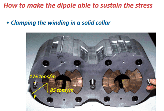

Helps calculate how much collar is needed -- often quite a lot !
That part is fine to me, because they're just showing the body forces acting on that piece on the left.
My issue was just with their notion of "total" radial force... it's a bit like exerting a force of 1N on each side of a 3D cube and claiming that the total radial force is 6N, when of course we would either say the net force has a magnitude of 0N or that the force on any given side has a magnitude of 1N.
Maybe the integral of magnitudes is useful for something like data tables, though 😁

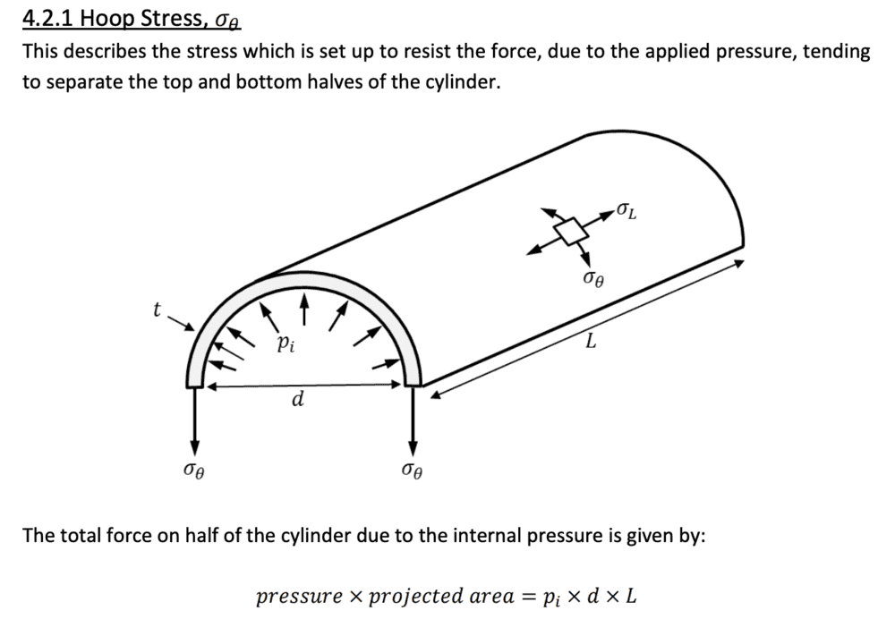

where total force is the vector sum, integrated over the element.
The first hit under https://www.google.com/search?q=pressure+vessel+"total+force" was
and again, the total force here is the pressure times the projected area, which equals the vertical component of the resultant force (not the sum of the magnitudes, which would be what we obtain if we integrated the magnitudes over the real area).
These all appear to support my position...
My issue is this. As a student, I can only judge what is "true" by the evidence presented to me. On the one hand, I have come across a multitude of resources (the above included) that define total force in the way I suggested.
On the other hand, experts like yourself and @fresh_42 have suggested it is defined differently. But I cannot accept this definition for two very big reasons. Firstly, I have come across no references for it. I think the burden of proof is on the party suggesting the new definition. Second of all, I see very limited circumstances in which your definition can be used, and in the vast majority of the literature the meaning is the one I have presented.
With that considered, I will continue to employ my current usage of the term. I will also, respectfully, reject your definition unless it is supported by a reference.
With respect, I believe this reference from a 19 century mathematician should conclude the discussion.
