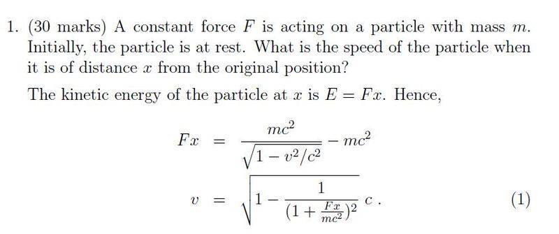

Can I do it like this:
[itex]F=γma[/itex]
[itex]F=γm\frac{dv}{dt}[/itex]
[itex]F=γm\frac{dv}{ds}\frac{ds}{dt}[/itex]
[itex]v\frac{dv}{\sqrt{1-\frac{v^2}{c^2}}}=\frac{F ds}{m}[/itex]
The finial answer will becom
v=[itex]\frac{\sqrt{2c^2mFx-Fx}}{mc}[/itex]
What's wrong?
[tex]F=\frac{dp}{dt}[/tex]
[tex]F=\frac{d}{dt}(\gamma mv)[/tex]
[tex]F=\gamma m \frac{dv}{dt} + mv\frac{d\gamma}{dt}[/tex]
Because gamma is a function of v and varies with time, you run into problems. You should still be able to solve it this way if you take the extra term into account, but it's a lot more work than energy conservation method.
