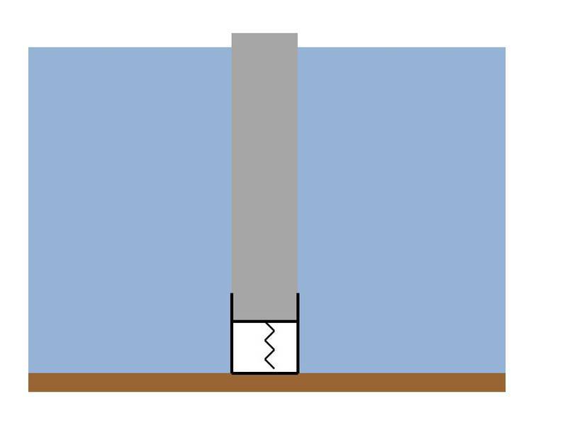

OK let's try this: Imagine the support is perfectly rigid and cannot be compressed (idealized case). What upward force is being applied to the cylinder now? Just a normal reaction equal to the air weight of the cylinder. Thus the support is completely supporting the cylinder.
If you try to pick up the cylinder the force required would be equal to the air weight of the cylinder (same as the reaction force prior to lifting it off). At the infinitesimal moment you lift the cylinder off of the support that reaction force is no longer there and the force required to move it up (until the hydrostatic pressure started acting on it) would be the air weight of the cylinder.
Alternately, imagine the support being a perfectly rigid cylinder with a spring scale inside (sealed - frictionless - from the water). Lower the cylinder onto the spring scale and evacuate any water. How much force is registered on the spring scale? The air weight of the cylinder.
Now get rid of any type of support from the bottom of the tank. Place the same cylinder on the bottom of the tank. If no hydrostatic pressure acts on the bottom surface of the cylinder there is no additional external upward force. The only force is the normal reaction of the tank on the bottom of the cylinder.
CS

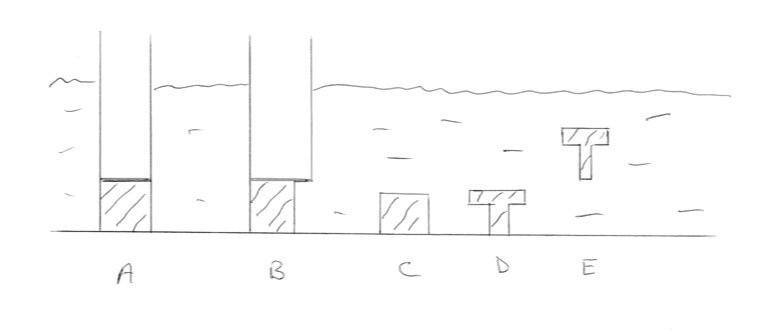

Haven't you guys been busy while I've been having my dinner?
I owe you an apology, Mapes. I took the weight of your second box to be greater than the water it displaced. If its weight was less it could mean that the vertical stresses acting on the support box are either greater than or less than the horizontal ones.
But consider there is actually no need for your second box at all in the argument.
Once the second box is firmly fixed to the support it effectively becomes part of the support.
So you could consider any horizontal section through the support and ask
As a result of the poisson effect is there a bouyancy force tending to lift the material above the section away (upwards) from the material below?
As an aside. What if the second box overhangs the support?
There will indeed be an upward bouyancy force acting on the second box given by the horizontal area of overhang times the pressure at the overhang.
Similarly suppose your support box was T shaped. There would be a bouyancy force acting on the underside area of the T in contact with the fluid.
Your suggestion is tantamount to saying that a T shaped support would experience a bouyancy force equal to the weight of fluid in its entire volume, not just the exposed flange.
Mapes said:
I'm not quite able to visualize your second thought experiment, the one with the spring scale inside the rigid cylinder. A diagram would help. But please, think about the current thought experiment before switching to a new one, so I can see which specific equation or calculation you disagree with.
Here is a diagram.
Note that the white part is evacuated.
CS
stewartcs said:
By rigid I mean the shape doesn't change which means there is no Poisson's Effect. Take away that effect and take another look at your position.
That Poisson effect stuff was a wrong approach I took to try to understand the problem. In the end, it has a minimal effect for a sufficiently stiff support. So forget about Poisson contraction or elongation, it's not relevant. I've added a note to the bottom of post #39 to make this clear. Sorry about the detour, I'm been trying to converge toward a solution too. But I stand behind the position that an empty cylinder is buoyant even when its bottom is not exposed to water, based on the comparison of stress states in posts #42 and #44.
Yes, exactly. The buoyant force depends on the volume of water displaced, not on the shape of the cylinder or its orientation or attachment method. Otherwise you could create an non-conservative force at will simply by attaching it or detaching it, or by rotating it effortlessly. This would constitute a perpetual motion device.

The buoyant force doesn't not simply depend on the volume displaced. Take a look at the picture in post #52. The cylinder obviously displaces water, however it will experience no buoyant force.
Mapes said:
Asked and answered in post #42. The buoyant force that I argue exists is independent of the support stiffness or of any material properties except for cylinder weight. No material properties of the support appear in the buoyant force prediction [itex]\rho g A(h-t_\mathrm{supp})-W_\mathrm{cyl}\approx\rho g Ah[/itex].
The object's weight has nothing to do with the buoyant force.

To those saying that the buoyant force completely disappears if liquid is excluded from the bottom of the cylinder, please consider again my diagram in post #20, where no liquid contacts the cylinder bottom, but I predict a measurable upward displacement and associated force. Is there an error in this reasoning?
Yes, there is an error in your reasoning. You have stated that an empty cylinder is sitting on the platform. This very statement is an acknowledgment that there is no buoyant force. An empty cylinder would normally float. OK, you glue it then because you think there is buoyant force, but it's not necessary to glue it.
You have correctly noted that the force (or pressure) on the top of the platform has changed, when the cylinder is placed, but buoyant force is all about the force on the cylinder not on container. If there is a gap between the cylinder and the platform, then there is buoyant force on the cylinder, and downward pressure on the top of the platform. The water in between is pushing in both directions- upward on the cylinder and downward on the platform. When the seal is made and no water is in between, both forces are gone. The cylinder has no buoyant force and the platform top no longer feels the water pressure (it feels atmospheric pressure plus the cylinder's weight per unit water-plane area.
Did you read my post #21 that followed yours. I mentioned the stresses on the container. They are indeed important, but they should not be interpreted as buoyant force.
OK, got it. I've been interpreting any stress changes in the system due to the presence of the cylinder as buoyant forces, but this was misguided. And I realize that several of you have worked hard to point this out to me. This has been a great learning experience in visualizing forces and energies. Studiot, stewartcs elect_eng, and russ, thanks for a very stimulating discussion!
