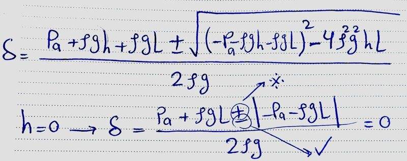

Can I find δ using :
PatmL/(L -δ) = Patm+ρg(h-δ)

At h=0 delta should be zero. The above equation confirms this.
And we can see that if h goes to ∞ the delta goes to L.
  • #69
Seems good. I had to check whether that quadratic simplified, I didn't take it that far! Good Job!

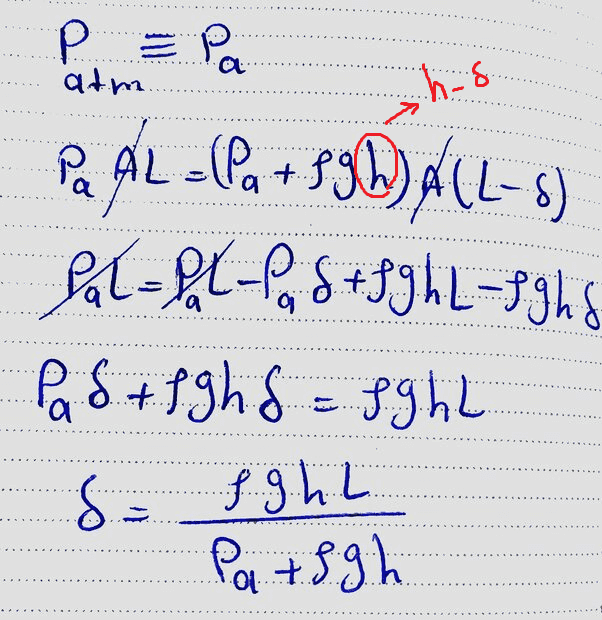

  • #74

Maybe I made a mistake ...
was my answer correct ??
  • #75

erobz said:
It plots identically to my solution?
Let me send you a picture of what I have done ...
  • #77
My mistake is here :
So to find delta we have to solve a quadratic equation ...
The question only asked about the increase and decrease of F force, I didn't want to waste your time at all... I'm sorry...
edit :
I have solved that quadratic equation ...

edit :
What you did on accident the first time by omitting ##\delta## was actually a really good approximation for ##\delta \ll h##. For the parameters I used I couldn’t tell the apart.
