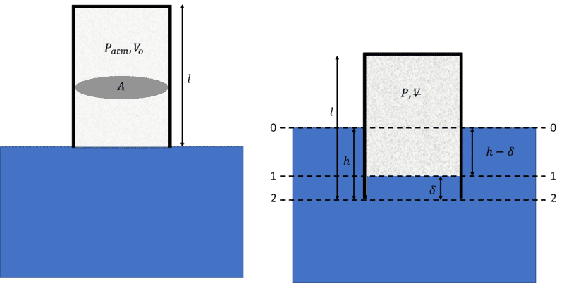

Suppose we put a glass upside down in water at a high speed. Therefore, the air inside does not escape. As the glass goes down in the water, the pressure increases and the air inside the glass is compressed (its volume decreases). How to apply the force F so that the object moves downwards at a constant speed? (The depth of the container is infinite.)
Newton's second law
Archimedes' principle
My answer : According to the question, the glass and the air inside it entered the water. Let's assume that the net force becomes zero at a moment, that is, the sum of the weight force and F is equal to the buoyancy force. By going down in the water, the gas volume decreases, so the buoyancy force also decreases, as a result, F also decreases. From time to time, the gas volume stops decreasing, as a result, the buoyancy force and F remain constant. So F decreases after equilibrium and remains constant after stopping the decrease in volume.
Can someone tell me Why my answer is wrong ?!
MatinSAR said:
Homework Statement:: Suppose we put a glass upside down in water at a high speed. Therefore, the air inside does not escape. As the glass goes down in the water, the pressure increases and the air inside the glass is compressed (its volume decreases). How to apply the force F so that the object moves downwards at a constant speed? (The depth of the container is infinite.)
Relevant Equations:: Newton's second law

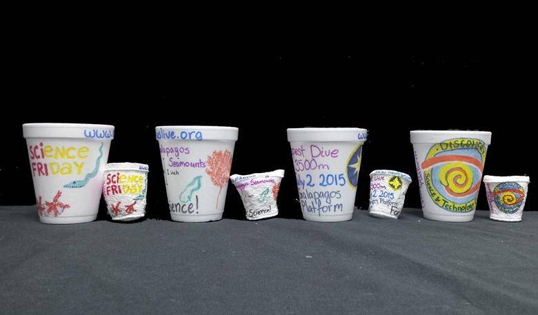

Did anybody explain to you why is your reasoning considered to be incorrect?
Please, see what happens to styrofoam when it is submerged:
https://www.sciencefriday.com/educational-resources/high-pressure-in-the-deep-ocean/

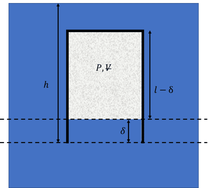

@MatinSAR
I've spent some time analyzing this, I think I've worked it out. This isn't a trivial problem IMO ( as far as analysis goes). Once you figure out what is happening with the gas in terms of the work being done by ##F## to compress it, then what is happening with the force becomes obvious as ##h## gets very large. However, try to use the accompanying diagrams to first formulate Newtons 2nd for the force ##F## required to very slowly (at constant velocity) push the cup down to a depth ##l## such that it is just fully submerged, before moving on to your actual question.
Some good assumptions to make IMO:
  1. Isothermal Compression of an Ideal Gas
  2. Weight of air is negligible
  3. Density of cup ( having mass ##M##) is large in comparison to the density of water i.e. ## \rho_M \gg \rho_w##
  4. Very large reservoir such that its change in height is insignificant from displacing the volume of the cup+ gas
Notes: Take care when dealing with absolute and gage pressures, and the forces acting on the cup due to them.
I started by equating the absolute hydrostatic pressure at section 1-1 to the absolute pressure of the trapped gas in the cup. The motivation is to determine ## \delta(h)## ( ##\delta## - the change in volume per unit area of the gas as a function of the depth ##h##). You will then use that result in formulating Newtons 2nd Law for the forces acting on the cup.

No, because it's tied to the pressure pushing back at you from the compressing the gas. The buoyant force from the gas tends to 0, but the compressive force from the gas goes the opposite way.
Wait, what? "Compressive force from the gas"?
You've drawn your system boundaries in the wrong place. There is no such external force on my closed system consisting of the glass plus the entrained air.
Assume it behaves as an ideal gas always. But ignore the compressibility of glass and water.
MatinSAR said:
Can't we ignore decrease in gas volume at great depth?
If it gives a different answer to the posed question, you can't ignore it.
The force ##F## is compressing the gas in the container. There is no bottom to the container.
There is a force ##F_\text{top}## acting on the top of the container. There is a force ##F_\text{bottom}## acting on the bottom of the compressed gas.
There is a name for the vector sum of those two forces.
