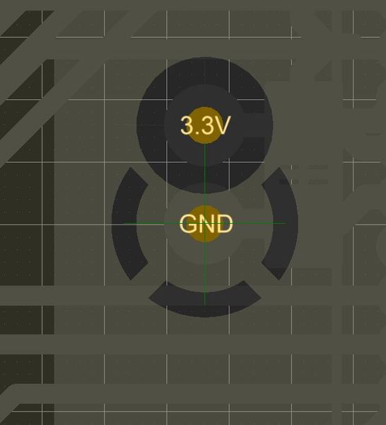

One issue that I realized is that I can't place the vias too close together. Suppose I have a 3.3V and a GND via. The 3.3V connects to the 3.3V plane using a thermal relief. However, the GND via is running very close to it and sometimes the dead-copper around this via runs into the thermal-relief. They are not shorting, my EDA package would tell me if they were. I will provide a picture in a few hours - I'm not on my computer at the moment.
I've managed to fix this in areas where I'm not decoupling and hence the via distance isn't too much of an issue. I'm a bit reluctant to do this on vias which connect the decoupling caps - but should I move the vias a couple of mills apart? Is this a big issue or makes no difference?

I know exactly what you mean as I fight this problem. I layout most of my boards ( say all!) as layout is the most important part of the design and you need to know the circuit to do it. Go to pad stack and define the pad size of the thermal. A lot of the default pad size of thermal are bigger than the regular vias, this to me is stupid. You can reduce the size, define the ring to less than 5mils, set the spoke width to 15mils. I just make the inner pad of the thermal same size as the normal via size.BUT in your picture, I don't see a big thermal, so I don't see your problem. I am saying in general case that I would fix the default thermal pad stack.

Here's the picture I promised, but it seems yungman already provided a solution :):

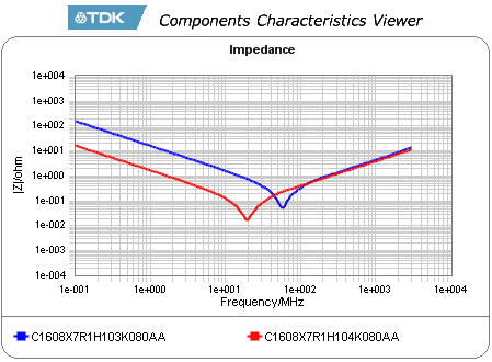

This is questionable advice. The package size (i.e. the parasitic inductance) is the driving factor that determines how effective the decoupling capacitor is at higher frequencies. I've plotted the mentioned values in 0603 sizes with TDK's Component Characteristics Viewer and I, for one, wouldn't sacrifice the obvious benefit at low frequencies for that narrow band where the 0.01uF cap is superior.
The best advice on this topic that I've seen, is this: choose the smallest package that is practical for the application and then choose the largest capacitance value that is available in that package size (or perhaps the second largest to avoid availability/lead-time problems).
Comments are welcomed (of course).
