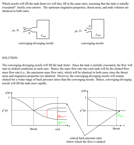

Then do you agree with this question and solution?
Yes, given the exit pressure is an initial condition, the exit Mach number is obtained by the exit pressure via the stagnation pressure definition. So you can choke the flow.

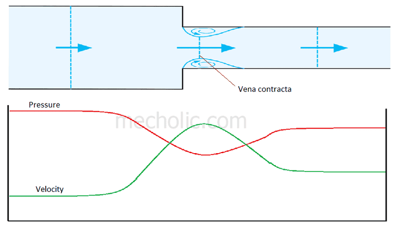

When too abrupt, any type of area change becomes a converging-diverging nozzle by the effect of vena contracta.
This is a good point.

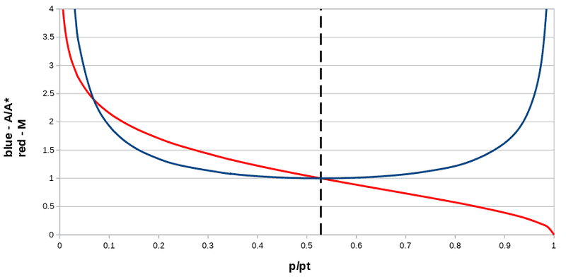

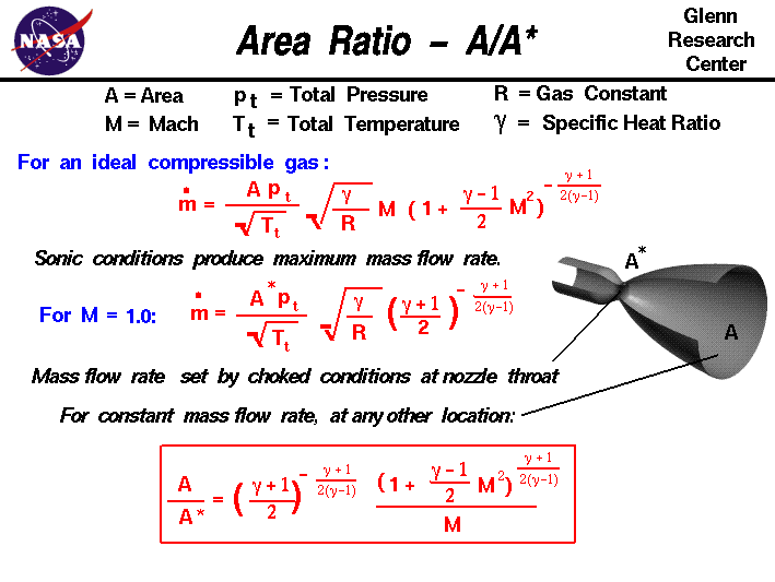

Any exit pressure can create a choked flow given the proper exit area. The equation for the area ratio is:
The exit Mach number ##M## is found with the exit pressure ##p## from the stagnation pressure definition:
07b10af5c630b13347ec276b2c1ba434b7a8ad6e
So for every ##\frac{p}{p_t}## there is a corresponding exit area ##A## that will choke our flow at the throat. (Remember, the throat area ##A^*## is fixed in our scenario.) Here is how it turns out:
If the exit pressure is ##0.528\ p_t## (dashed line), the area ratio is 1 because the exit Mach number is 1 and thus you have a choking condition at the exit; you thus have no diverging part in your nozzle. On the right side of the graph, the exit Mach number is subsonic, and on the left side, it is supersonic.
The angle doesn't matter, it is just a question of area ratio.

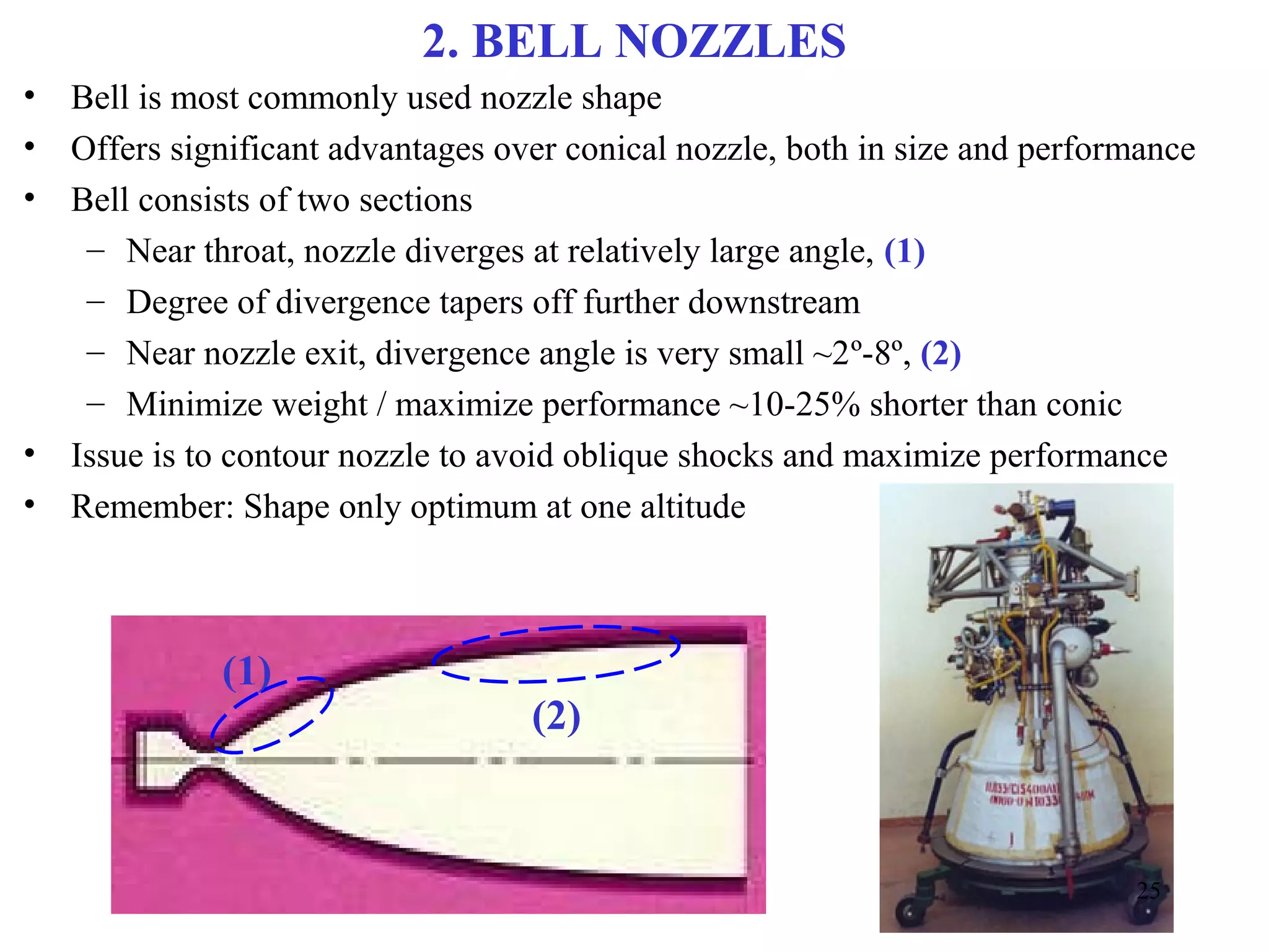

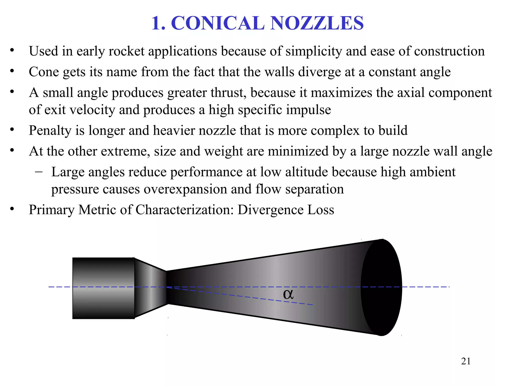

From memory, the limits for minimal losses is a 60° converging part with a 7-10° diverging part.
(source)​
Note that these angles are also true for exterior flow. To minimize flow separation, you will have a 60° windshield and 7-10° back window and trunk on a car with the smallest coefficient of drag.
