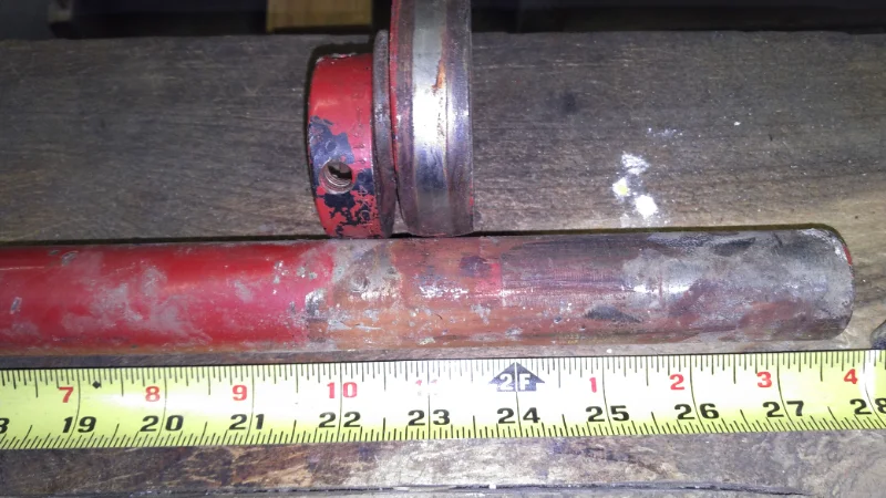

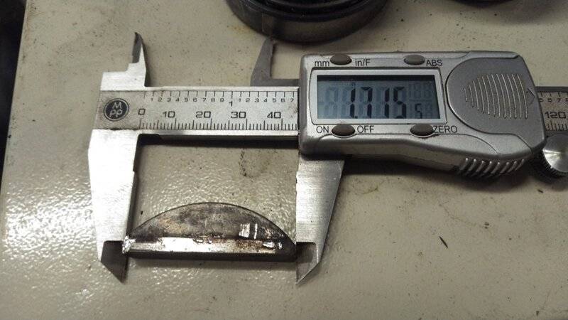

I need to cut keyways in a new shaft to replace the broken old shaft. It's easier for me to cut straight keyways into the shaft than a woodruff.

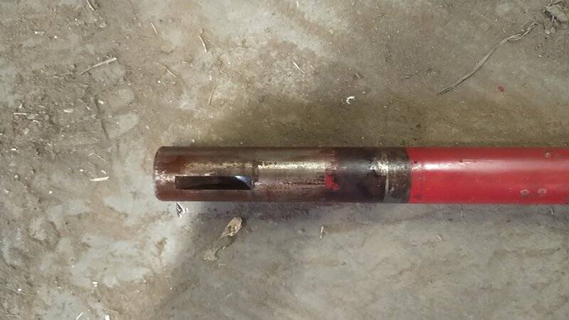

I have a broken 1.25 inch diameter shaft. One end has a large pulley attached I'm guessing around 16 inches in diameter with a pair of setscrews and a straight key to hold it to the shaft. The key is a square 5/16 inch key.

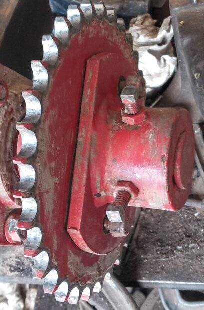

The other end of the shaft has a hub with a keyway cut into it the entire length of the bore. This is where the woodruff key is used also with a pair of setscrews. The width of this key is also 5/16 inch. This hub is attached to a sprocket with two bolts used as shear bolts. The sprocket is able the freewheel on the shaft in the event that the bolts shear. The hub is near the end of the shaft. It is easier for me to cut a straight keyway in rather than a keyway for a woodruff key so that is what I'd like to do. Opinions?
The advantage of a woodruff key is that it stays where the semicircular pocket is sunk, while the position is still adjustable. The woodruff key maintains index but will not transfer much torque. Some form of clamp must be used to lock the two parts after assembly.
Unless it is held positively, a normal rectangular key can creep or slide along and out of the slot in the shaft and the pulley.

That's the only reason I can see for it in this case. By the pictures you can see it is close enough to the end of the shaft so that is a possibility. Honestly I'm not to worried. On a production scale the way they made that was likely the sensible choice. As a replacement shaft, a drop of loctite in the shaft keyway should prevent movement. A ding in the bottom of the keyway with a center punch just past the end of the key would prevent it also.

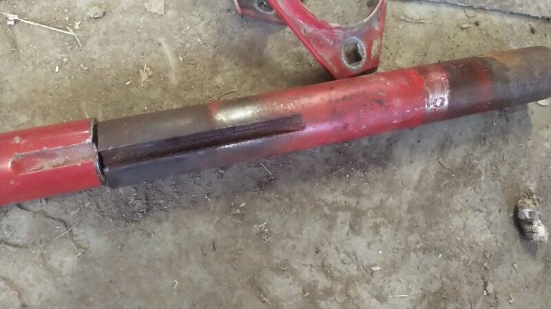

If you notice where the shaft broke you'll see it is right next the the hub. Not even enough stub shaft sticking up for the press to push on to get it started moving without a spacer. The shaft didn't break perfectly square so the spacer didn't set square. I won't press on anything set up like that due to safety unless the spacer is very short so it was a slow process.
To me, the break in the shaft is the weak point in the whole design. The break right next to the pulley hub indicates the shaft is too weak for the load. The shear bolts never gave. So my change to a square key is not likely to cause any more trouble than the OEM one did.
A roller chain sprocket always presents a side force, and if under too much tension, a hammering as each roller passes. That could quickly reach the cyclic fatigue limit of the shaft.
It would be interesting to examine the sprocket tooth profile for wear on the working face, and test the chain for stretch.
The overall length of the shaft is around 32 inches. The break in the shaft is next to the large pulley. The sprocket is quite close to the end of the shaft. There is a sealed ball bearing right next to it. About 24 inches over from that is the break in the shaft right next to the large pulley. Opposite side of the pulley is another sealed ball bearing. My opinion is the shaft is too small for the load in combination with the length. I think the flex in the shaft in combination with the large pulley hub acting like a shoulder cut into a shaft. Often times the shoulder causes a weak spot.

I would think Woodruff keyway minimizes the stress concentration in the shaft. So if your shaft is already weak...
Also:
https://slidingmotion.com/what-is-woodruff-key/#Disadvantages_of_Woodruff_Key said:
Where & Why woodruff key is used?
It is mainly using to fix the tapered shaft into the hub or gear. It gives a good fixing area for the shaft as its top flat surface gets to engage with the hub/gear to get better fixing.
There's no doubt that there's less material removed to make the key seat with the woodruff. I'll take a few more pix and post. @Baluncore implied there should be more pix. Never replied to my question about what specifics he wanted to see.

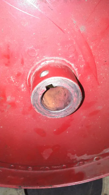

I need to see the pulley and the pulley key, plus the position of bearings on the shaft relative to pulley position. Is the pulley for a v-belt, single/multiple, or flat? How much belt tension?
Not in a position to get a pic of it right now but will later. I can tell you the pulley is mounted on the shaft directly to the right of the break. You can see the dark colored part where there is no paint in the pic. That's where the pulley was mounted. You can see the length of the keyway and the key didn't protrude out from under the hub of the pulley. Specific measured lengths I can't tell you until I get a tape measure and check it. Post #5 gives a basic description. The belt tension I have no idea since a hydraulic cylinder moves an idler pulley to engage and disengage rotation of this shaft. There is spring tension to take up the excess so it's not likely to be tightened to the point of damage. Single belt, 7/8 inch width.
@Baluncore

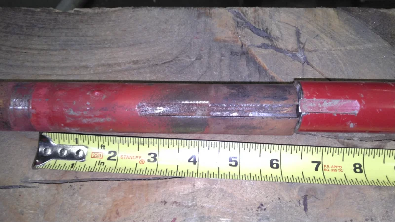

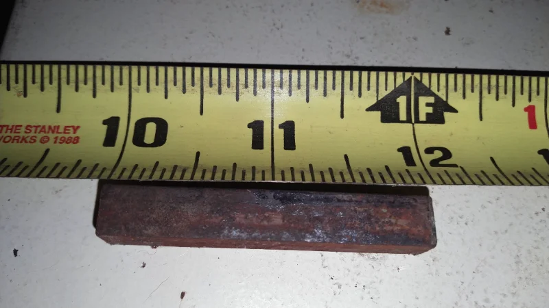

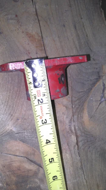

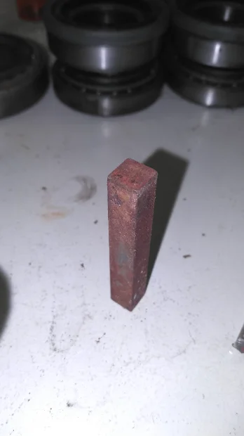

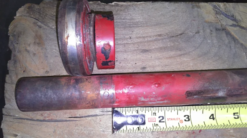

Here are some pix as promised.
The key on the pulley:
Bore of the pulley hub:
Positioning of the bearing and pulley and shaft break. Length of the pulley bore can be noted where there is an abrupt lack of paint:

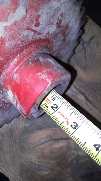

Sprocket end. Nothing broke here. The rectangular hub is a press fit to the shaft. The sprocket will freely turn on the shaft in the event of sheared bolts between the hub and sprocket:
Distance to sprocket end. Tape measure wasn't moved for all pix. Hub is installed next to the bearing. Again, note the missing paint.
