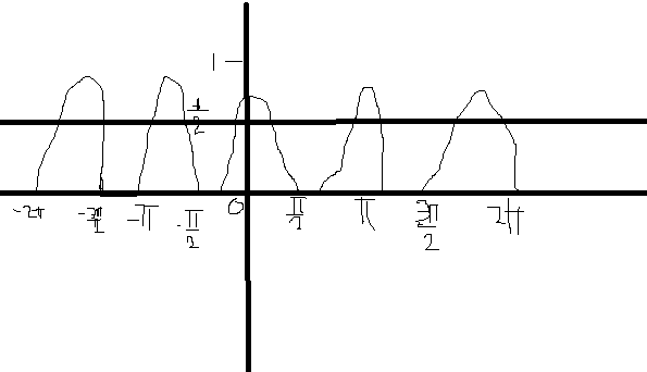

Would the graph of |cos x| for values of x between 0 and 360 be a normal cosine graph?
2nd question
For what values of θ between -2∏ and 2∏ is |cosθ| > 1/2?
Well... I know Cos 0 is 1, Mod Cos ∏ would be 1, Mod Cos 2∏ would be 1. Am I on the right track?

Definitely on the right track. Now, you know that |cos π|=1, but what is cos π? If it's not the same as |cos π|, then the graphs aren't the same, are they?
For the second question you might first work out when |cos x| is exactly 1/2.
I figured out the answer to the first question the graph looks like umm how do I describe like no part of it goes to the negative side of the graph. the Amplitude is 1.

Right, and there are other values x with |cos x| = 1/2. Try sketching the graph (a rough sketch is all you need to get an idea of what we're looking for) of |cos x| between -2π and +2π, and draw a horizontal line 1/2 unit above the x axis. Then you should be able to guess the other solutions of |cos x| = 1/2.
Let's call those solutions a, b, c, d, e, etc. See how the curve forms "hills" and "valleys" between these points? And they alternate, so if there's a hill between a and b, you get
valley between b and c
hill between c and d
valley between d and e
hill between e and f
etc.
Is it supposed to look something like this?
and the solutions are at the troughs?
It was supposed to reach 1 but I drew this in paint so...
That sketch is just what I meant. Easily done, and you can get a feeling for what the graph looks like. You need to check the values at -5π and +5π though. And you need to decide whether you're going to work in radians -- using π a lot -- or degrees -- then you'd need to change the scale to read
-360°, -270°, -180°, -90°, 0°, 90°, 180°, 270°, 360°.
Mark the first colution of |cos x| = 1/2 at x = π/3 (i.e. 60°) and you should be able to find the others.
Finally, since you want |cos x| > 1/2 (not < 1/2) you're looking for the hilltops, and not the valleys.
lol it's not a -5 it's a 2 my penmanship is extra poor on paint.
So I marked |cosx| = 1/2 at -60,-120,-240,-300, 60,120,240,300. So is the answer like should I like split the parts of the graph into like it's own each inequality, I don't know how to explain what I mean... like.. one part be -360<x<-300?? and then the next one is between 240 and 120 or w/e ?
That's right; you get separate ranges which you could write like this:
We have |cos θ| > 1/2 for
  • -360° < θ < -300°
  • -240° < θ < -120°
  • -60° < θ < 60°
  • 120° < θ < 240°
  • 300° < θ < 360°

I'm kind of confused though if I was to find the |cos| of like -61 it's not bigger than 1/2
Of course, |cos(-61°)| < 1/2 .
Look at the intervals given by Michael Redei .
... sorry... the conditions hold true.
You can see that in your sketch. Start from 0° (height 1) and go left, then you'll be going "downhill". At -60° you've reached the height 1/2, and if you continue further, say to -61°, you'll be below the level 1/2.
Here's a graph from WolframAlpha.
