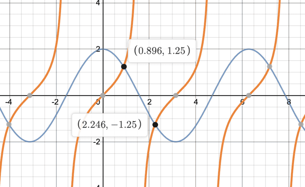

I have really been rather struggling with trigonometric equations, hwoever I have been teaching myself and practising to improve and hone my understanding. Although, I remain a little uncertain in areas. I have attempted some questions below but was wondering if anyone could offer me some advice on how to improve my workings or apply more suitable methods.
Sketch the graphs y=2cos x and y=tan x.
a. How many values of x satisfy the equation in the range 0 ≤θ ≤360 degrees?
b. Show that the x-values at the points of intersection satisfy the equation 2sin^2x+sins-2=0
c. Solve the equation 2cos x=tan x between 0 and 360 degrees
tan x=sin x / cos x
sin^2x+cos^2x=1
a. I have just plotted the graph using desmos and attached an image here. Clearly, there are two values of x that satisfy the equation in the range. Do I need to add anything to this statement, I feel the response is a little brief for the question?

With respect to (a) shouldn't your graph use degrees in the x-axis as it asks for the intersection points with the domain of 0 to 360 degrees and your plot doesn't show that.
For (b), you start with ##2 cos(x) = tan(x)## and then multiply both sides by ##cos(x)## and you should get ##2 cos^2(x) = sin(x)## right?
Thank you for your reply. Yes you are correct, I just quickly jotted down the graph from Desmos, in actually sketching it I would use degrees on the x-axis.
