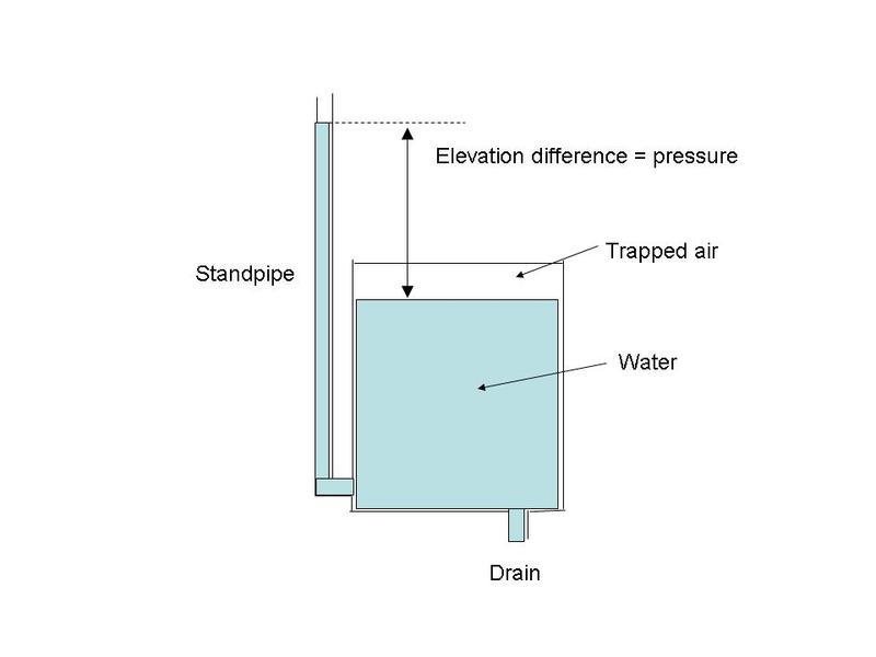

How much overpressure (air) do you need? How about using a standpipe say 2 feet higher than the tank will give ~ 1 psia, with the standpipe filling the tank at the bottom? Any bubbles in the tank will stay in the tank.

See my sketch of a standpipe for maintaining pressure and trapped air in tank while filling with water.
Bob S

2) do the standpipe suggested by BobS. This does basically the same thing as I've suggested.

thank you all so very much! every bit has helped me a lot. i have a question however in regards to the standpipe approach. With reference to bobS' picture, wouldn't that trapped air at the top prevent any water from entering via the standpipe?
Yes, that's true for the standpipe or the liquid trap. As I tried to explain above, if water isn't removed (say, through the bottom "water outlet" shown in your diagram) air pressure increases as water enters the tank. If air pressure increases to the same pressure as the incoming water, flow will stop. The only way to add more water is to either remove water through the outlet or force it in by increasing water pressure.
The normal standpipe solution (like the one given by Bob S) has the inlet to the tank on the lower side of the tank.
If you absolutely have to have the valve on the top of the tank, simply add an extension to the valve (a nozzle, if you will) all the way to the bottom of the tank. That way, you are always filling from the bottom, up.
