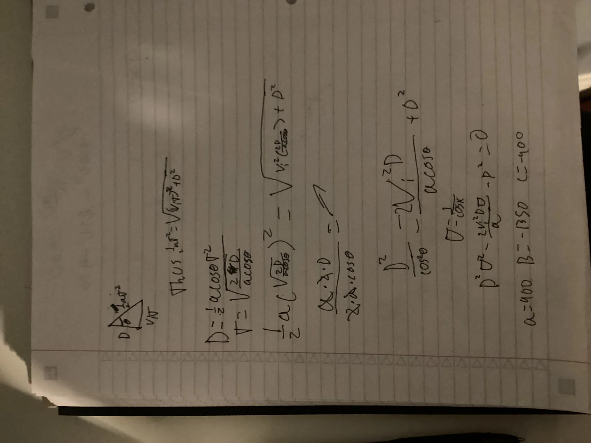

I do not know what this means
1/2AT^2
VT
D?
I was able to solve the problem, but my solution feels lengthy so i was curious if there was a mathematicallly simplier way to approach this problem.
Textbook page showing the PROBLEMS heading and Problem 1 text, with Figure 4-40: particle A at height d on the y axis moving right with velocity v, particle B at the origin accelerating along a dashed line at angle theta from the positive y axis.
Handwritten derivation, rotated on the page, showing a velocity triangle with D and V1 and the relation 1/2 mU^2 = (1/2) m(V1^2 + D^2), followed by algebra solving for D and V with cos theta and a quadratic in V with coefficients A = 400, B = -1350, C = -400.
Not sure if it's shorter or simpler, but it avoids trigonometric functions until the very end:
- Use Pythagoras to get the time to impact ##t##
- Use ##t## to get the horizontal distance ##s_x##
- Use ##atan## to get ##\theta##
This would be my first guess too. Note that Pythagoras yields a quadratic in ##t^2##, so I think finding the hypotenuse and using ##\cos^{-1}## is slightly shorter.
