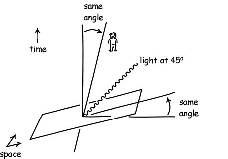

I don't think I have thought of this way to find the direction of the orthogonal vector before. The image I visualize is simpler. Here's one I found using Google:
If the 4-velocity is a point in the almost vertical line in the picture, then the 4-acceleration is a point in the almost horizontal plane. In the comoving inertial coordinate system, that line is just the t axis and that plane is just the xy-plane. Every point in that line is orthogonal to every point in that plane. (Note that the two angles indicated in the picture are the same).
This is the web page where I found the image. I haven't read the text, but it has lots of nice pictures.
Yes, for the specific case of Minkowski spacetime, that image is consistent... and possibly simpler (after you have accepted that formulation of orthogonality). (You can use the Lorentz transformations or a radar-experiment to justify that formulation.)
My method works for the Euclidean, Galilean, and Minkowskian cases.
It builds on the tangent-is-perpendicular-to-radius idea hopefully-familiar from Euclidean geometry, which beautifully generalizes to these other geometries.
In addition, my method directly addresses the fact that
the magnitude of the 4-velocity or of the 4-momentum is not changed by a 4-force orthogonal to it.
