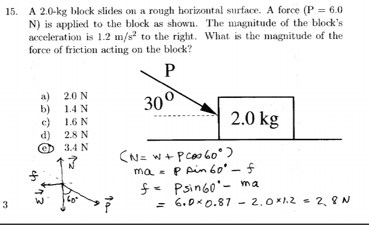

Is this a mistake on the answer key? (Newton's Laws)

Why is the angle 60 degrees? Isn't it 30 degrees? [/B]
Because the angle is being measured from the y-axis rather than the x-axis. The angle to the x-axis is ##30^{\circ}## and the angle to the y-axis is ##60^{\circ}##.

Ahhhh nevermind, i think they used the 30 degrees as the angle of the force from top left... Man. these problems are very unclear .

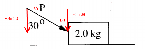

No it's clear. The 30 degree angle on the drawing is in the correct place. P is at 30 degrees to the horizontal axis.
The vertical component of P is PCos60 or PSin30 as these are same thing.
The horizontal component of P is PSin60 or PCos30 as these are the same thing.

Sorry if that was confusing, I agree with your solution.
