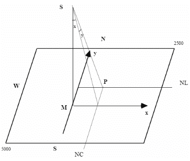

I have encountered this equation:
##\cos^2 \gamma = \cos^2 \alpha \cdot \cos^2 \beta##
According to the paper, this is a trigonometric identity, but this is the first time I have encountered this. The angles ##\alpha## and ##\beta## are somewhat similar to the components of the distance formula, and ##\gamma## is the resultant distance.

There's nothing we can do to help you if you don't tell us what ##\alpha##, ##\beta## and ##\gamma## are.
I apologize. Here is a figure to help you what the angles are:
The angles ##\alpha## and ##\beta## are the angles ##X## and ##Y##, respectively, in this figure. Whereas,
the angle ##\gamma## is the angle ##\theta## for this figure.
SM is orthogonal to MO and MP?
Set the distance (SM) to 1 - this simplifies equations but doesn't change the general case.
I don't understand the second sketch, let A be the point where the side between x and y hits the plane shown in the first sketch. Then (MA) = tan(x) and (AP) = tan(y)/cos(x) and ##\sqrt{(MA)^2 + (AP)^2}## = (MP) = tan(##\gamma##). See if that simplifies to the equation you have.
If I understood you right then all three angles are those at the top of the pyramide. My calculation with ##\overline{MS} = H = 1## and both sides ##= \frac{1}{2}## of the rectangle in the plane with ##M## and ##P## gave me:
$$\cos α = \frac{2}{\sqrt{5}} \;,\; \cos β = \frac{9}{10} \;,\; \cos γ = \frac{3}{4}$$
which fails the given equation.
Something went wrong in your calculation then, because the equation is right - at least with the assumptions I made in my post.
I get a different result for ##\cos(\beta)## and ##\cos(\gamma)##.

Yes, I found my mistake: wrong assumption on the triangle with β. But the general case still gives me some headache.
I calculated the approach I suggested, it leads to the identity in post 1 within a few lines.
Got it. I didn't understand your equation for ##(AP)## but the law of cosines with some Pythagoras did the job.
1/cos(x) is the length of the side where the angle beta is. No magic involved.

Use ##\sin^2(x) = 1-\cos^2(x)## to get rid of all sines (also those hidden in the tangents). To simplify the expressions, it is useful to introduce new variables like ##\cos^2(x)=a##, ##\cos^2(y)=b##, ##\cos^2(\theta)=c##.
I still don't have the ##\overline{AP}## part, but I can show you my approach.
##\cos x = \frac{\overline{SM}}{\overline{AS}} \; , \; \cos θ = \frac{\overline{SM}}{\overline{SP}}## so we have to show that ##\cos y = \frac{\overline{AS}}{\overline{SP}}##.
The law of cosine here is $$\cos y = \frac{\overline{AP}^2-\overline{AS}^2-\overline{SP}^2}{-2 \cdot \overline{AS} \cdot \overline{SP}}.$$
With the Pythagoras ##\overline{AP}^2 = \overline{MP}^2 - \overline{AM}^2## and ##\overline{MP}^2 = \overline{SP}^2-\overline{SM}^2## and ##\overline{AM}^2 = \overline{AS}^2 - \overline{SM}^2## the result follows.

Wait, isn't that circular? You use the law of cosines to prove that cos y is indeed the ratio of two angles in the triangle.
Actually, the three cosine definitions are sufficient to show the identity. The whole problem can be solved in two lines.

I don't think so. Basically I show that the law of cosine is equivalent to the statement that has to be proven. I simply convert all angles to (relations of) straight lines from ##S.## Pythagoras only substitutes variables and for the cosines of ##x## and ##θ## I use their definitions.
I believe you but I can't see it. Probably it will be embarrassing as soon as I understood your solution. I am already stuck at ##\overline{AP} = \frac{\tan y}{\cos x}.##

The derivation works for any M, and does not include the other angles at all. It is just a very complicated way to simplify the law of cosines for a rectangular triangle involving additional irrelevant steps.
Draw the triangle SMA, with a right angle at M. Then (SM) = (SA) cos x.
Draw the triangle SAP, with a right angle at A. Then (SA) = (SP) cos y.
Draw the triangle SMP, with a right angle at M. Then (SM) = (SP) cos ##\theta##.
This is assuming x,y,##\theta < \frac{\pi}{2}##, otherwise you cannot have the right triangles. Larger angles just lead to sign flips, squaring the cosines gets rid of those details.
Thanks, the right angle at ##A## in ##SAP## was what I was missing. I told you it would be embarrassing.
The equation for the cosine would be wrong otherwise - it works exactly if the angle at A in SAP is a right one.
The right angle can be derived from the two right angles at M (in SMA and SMP) and the right angle at A in MAP, so it is nothing you have to plug in manually.
Thank you very much for your help. I have successfully proven the identity.
