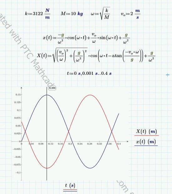

I'm trying to use the following trigonometric identity:
$$ a \cos ( \omega t ) + b \sin ( \omega t ) = \sqrt{a^2+b^2} \cos ( \omega t - \phi )$$ Where ##\phi = \tan^{-1} \left( \frac{b}{a} \right)## for the following equation:
$$ x(t) = -\frac{g}{ \omega^2} \cos ( \omega t) + \frac{v_o}{ \omega } \sin ( \omega t ) + \frac{g}{ \omega^2} $$
When I apply the identity I get:
##a = -\frac{g}{ \omega^2}##
##b = \frac{v_o}{ \omega }##
##\phi = \tan^{-1} \left( \frac{-v_o \omega}{g} \right)##
$$ X(t) = \sqrt{\left( \frac{g}{ \omega^2} \right)^2+\left( \frac{v_o}{ \omega } \right)^2} \cos \left( \omega t - \tan^{-1} \left( \frac{-v_o \omega}{g} \right) \right) + \frac{g}{ \omega^2} $$
However, on a plot they are not matching up...What am I doing wrong?
Mathcad worksheet with constants k = 3122 N/m, M = 10 kg, omega = sqrt(k/M), v0 = 2 m/s, formulas for x(t) and X(t), and a plot of X(t) in red and x(t) in blue against t from 0 to 0.4 s.
I suspect it may be related to the fact that
##\phi = \tan^{-1} \left( \frac{b}{a} \right)## can't distinguish ##\frac{b}{a}## from ##\frac{-b}{-a}##.
Try https://en.wikipedia.org/wiki/Atan2
or add ##\pi## to the result of ##\tan^{-1}## if the x-component is negative.
You can see from your original equation that CORRECTION the right-hand side is the same no matter what the signs of ##a## and ##b## are, whereas the left-hand side is different when a sign of ##a## or ##b## changes. Your plot of the right-hand side is correct for a positive ##a##, but your example has a negative ##a=-g/\omega^2##.
CORRECTION: I overlooked that ##\phi## of the right-hand side depends on the signs of ##a## and ##b##.

It is really common for people to be sloppy when they say ##\phi = tan^{-1}(b/a)##. As others have said, there are sign issues depending on which quadrant you are in. When things seem wrong always look at a sketch in the complex plane first. This is why all (good) programming libraries have the atan2 function. Also, beware, you'll see this mistake again, from yourself or others.
