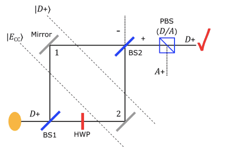

The paper provides a version of the effect using a modified Mach-Zehnder interferometer with a single detector:
A diagonally polarized light beam (D) is sent from the yellow dot (bottom left), passes by beam splitter BS1 and takes path 1 and path 2. In path 2, there is a half wave polarizer (HWP) rotating the state to an antidiagonally polarized state (A). As the two paths are different they do not recombine when arriving to the second beam splitter BS2. The photons that go to the right, pass by a polarising beamsplitter (PBS), which transmits beams with the original polarization (D) and sends it to the detector (red checkmark in the upper right). If the polarization was rotated
(A), it reflects it away from the detector.
It seems obvious that the photons that took path 1 are able to be detected. Photons that took path 2 seem not to contribute. The Cheshire effect here seems to appear when you slightly modify change the rotation of the HWP by a tiny amount (weak measurement). Under these tiny modifications, it seems that the number of photons detected is modified, implying some kind of quantum Cheshire effect! (modifications of the lower arm should not participate, yet it modifies it, polarization takes a separate path?!).
The result seems trivial, what I cannot understand is what is Cheshire like from it. Clearly modifying anything in the lower arm is going to rotate states in another basis providing more possible photons that can be detected coming from path 2. Sabine makes a similar remark, saying with authority that the interpretation where the cat"disembodied" it finally proven wrong!
The paper seems more conservative, it provides three not equivalent interpretations. I am having a hard time understanding the three different assumptions because they focus too much of contextuality and weak measurement remarks.
What do you think of it? Is this a valid quantum Cheshire cat? It seems too obvious to me, and I hope that I am misunderstanding something (as well as Sabine). It seems very obviously not a quantum effect, where is the catch?

Sure quantum mechanics has an intrinsically different way of handling it, however if we are going to talk of "Cheshire cats" we have to say what is so no-classical about it.
I would argue that such a systems can be efficiently simulated classically, either with classical waves or with classical pin ball balls: a red pinball ball gets classically stochastically send to either path 1 or 2, in path 2 it changes color to blue, replace the PBS for a ball color selector, if it is red the ball is detected if not the ball gets reflected away. However if there is some slight modification to the color so the ball can sometimes have some red, then it is detected, so now the ball can come from 1 or 2. There is nothing weird about it.

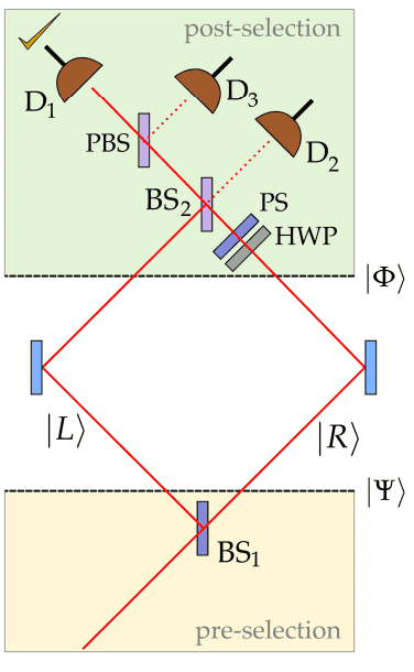

I was trying to read it but I get lost in the set-up. For example, if I understand correctly Aharonov et al. start with some state, let say ##|\Psi_0\rangle=|H\rangle|R\rangle## where ##H## is horizontal polarization and ##R## means moving to the right. The beam passes by the first beam splitter (BS1) so we get
$$|\Psi\rangle= \frac{(i|L\rangle+|R\rangle)|H\rangle}{\sqrt2} $$
where ##L## means moving to the left and ##i## is just a phase factor from reflection. My problem is what happens next.
Now the beam going to the right crosses a half-wave plate and a phase shifter, is it ok to say that now the state of the system is ##|\Phi\rangle##?:
$$|\Phi\rangle= \frac{|L\rangle|H\rangle+|R\rangle|V\rangle}{\sqrt2} $$
where ##V## means vertical.
And second question, if the above is true. What happens after the second beam splitter (BS2)? What is the state before the detection/PBS?
Note that the figure in the paper seems to suggest that ##|\Phi\rangle## is reached before the HWP and before the BS2.

Edit: if the beam splitter is like the initial one, the state after BS2 seems to be (not sure about the relative phase)
$$|\Phi_2\rangle=\frac{|R\rangle|+\rangle-i|L\rangle|-\rangle}{\sqrt2}$$
where ##|\pm\rangle=(|R\rangle\pm i|L\rangle)/\sqrt2##,in which we only care for the ##|+\rangle## state according to the paper.
Weird enough the paper cited by Sabine seems to invert the postselected state with the preselected state in comparison with Aharonov et al.
