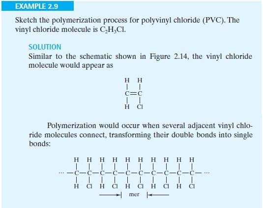

(see attachments for example 2.9)

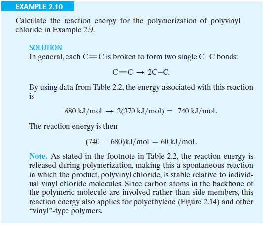

As far as I have read and understood, most polymerizations (such as the one in this example) are exothermic. If this is the case, shouldn't this produce a negative (-) reaction energy? And the equation they should have used is the one I included in section two (2)?
Thank you in advance for any help.
-E

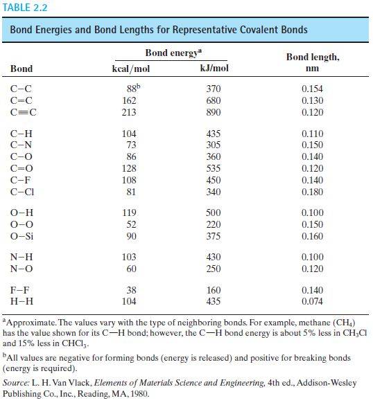

Forgot to add example 2.9...
And Table 2.2
Unless they are defining "reaction energy" differently from usual, the blue box is wrong. You input the energy to break the C=C bond, and the energy of forming two C-C bonds is given out. So the enthalpy change is +680 - 740 = -60 kJ/mol. They may be confused by the fact that
ΔHrxn = Hproducts - Hreactants
But this is not equal to BEproducts - BEreactants
Relative to the state where all bonds are broken, H = -BE. So your white box is right.
