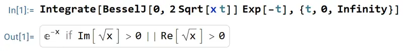

integral equality: is this integral correct ?
$$ exp(-x)= \int_{0}^{\infty}J_0 (\sqrt{xt})exp(-t) $$
i have expanded the bessel function into power series and integration term by term

Almost! According to Mathematica your result is missing a factor of 4:
thanks how about if i put ##J_0 ( 2\sqrt{xt})## instead my original bessel function ?
Yes, that removes the factor of 4 from the answer, as is evident by making a change-of-variables in the first integral above:
