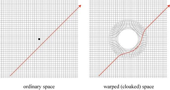

From a quick read of the abstract and introduction, this seems to be a purely Electro-magnetic phenomenon, and doesn't have anything to do with the gravitational wormholes that we usually mean when we use the word "wormhole". It sounds like what they are doing is taking a magnetic field, and then, by some complicated arrangement of materials of varying magnetic permeability properties, making a part of this field "disappear" (they use the word cloaked) in 3-D space. Thus there seems like there is a discontinuity between the source and the sample point where the magnetic field does not appear. Someone can correct me if I'm wrong.

Here, we give related constructions of invisible tunnels, which allow electromagnetic waves to pass between possibly distant points, but with only the ends of the tunnels visible to electromagnetic imaging. Effectively, these change the topology of space with respect to solutions of Maxwell’s equations, corresponding to attaching a handlebody to R3. The resulting devices thus function as electromagnetic wormholes.
That's way over my head, but the phrase that interested me was "change the topology of space". Correct me if I'm wrong, but isn't that kind of like what a mass is supposed to do to its neighboring spacetime? Or, is that just a change in the metric with the same topology?
I would think that, if this "wormhole" they've created really changed the topology of space (everything I've read indicate R3 rather than R4), that would be something really, really significant. But is that really what's happening, or is this just a really, really good mag shield? Or, is it just a mathematical convenience: they did say "with respect to solutions of Maxwell’s equations" and "corresponding to attaching a handlebody to R3".
Unfortunately, it's going to take me too long to learn all the background I need to read Greenleaf et al for me to understand this in any significant way. I was hoping someone here might have already traveled that road and could tell us if this is an actual, real change in space topology, or are they just being mathematically metaphorical?

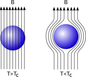

https://en.wikipedia.org/wiki/Meissner_effect
The meissner effect repulses the magnetic field it is a function of the YBCO while the Metamaterial Traps still transmitting the signal making it "Disappear" then when the affect ends at the end of the tunnel it "Reappears"
https://en.wikipedia.org/wiki/Negative_index_metamaterials
There is your answer it does nothing to real space
