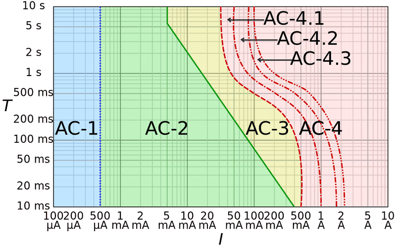

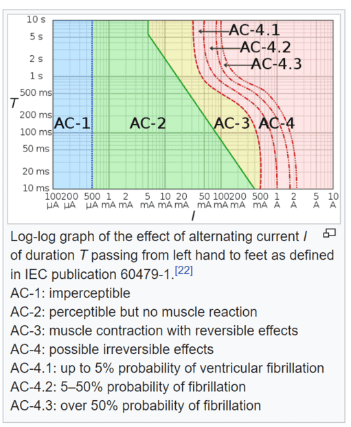

Lethality is not linear, no matter what your unit of measure, voltage, current, power. The linked article has some interesting info.
https://en.m.wikipedia.org/wiki/Electric_shock#Pathophysiology
Log-log graph of the effect of alternating current I of duration T passing from left hand to feet as defined in IEC publication 60479-1.[18]
AC-1: imperceptible
AC-2: perceptible but no muscle reaction
AC-3: muscle contraction with reversible effects
AC-4: possible irreversible effects
AC-4.1: up to 5% probability of ventricular fibrillation
AC-4.2: 5-50% probability of fibrillation
AC-4.3: over 50% probability of fibrillation​

By the way, work is energy, Watt-hours are energy, and watts are the rate of delivery of energy. That's where the time axis on the lethality chart in #4 comes in.

Thanks guys, I read the wikepedia article and I get the jist of what you are saying overall. I can see the graph above is on logarithmic paper rather than lineal.

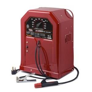

No shame in never having needed to electric weld. I was introduced in 9th grade shop class.
I recommend the classic homeowner Lincoln cathedral buzzbox. Arc stays lit way better than those frustrating 110 volt cheapies.
Around $100 at yardsales
Once you've owned one you'll never again be able to live without.

Here's a more nuanced view. It plots time versus current. But if current and volts are proportional, the horizontal axis could be power in watts. Time*power = energy measured in joules. The upper right corner in that plot is the most energy.
https://en.wikipedia.org/wiki/Electrical_injury
